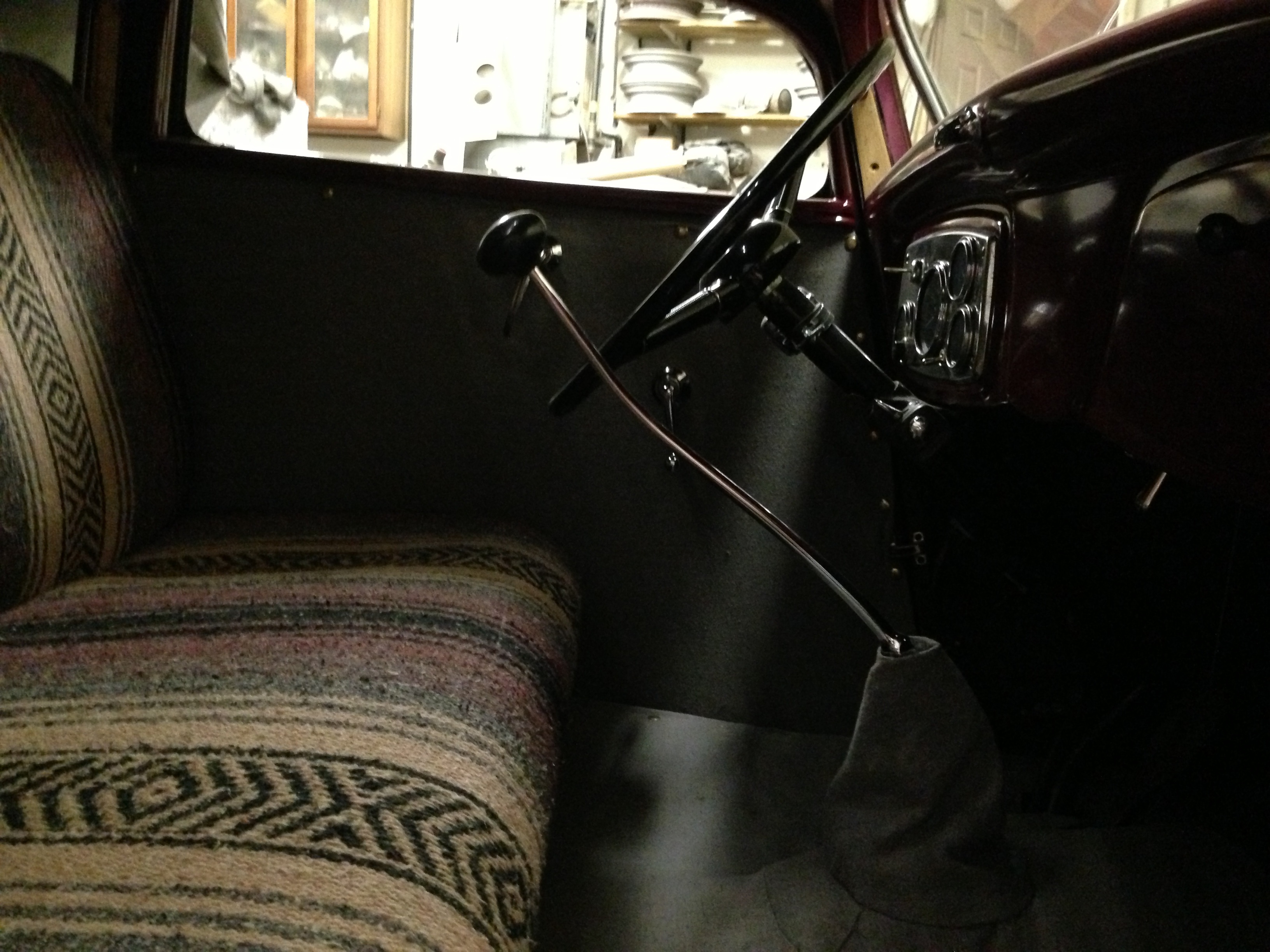

    Here is a T5 shifter with a 39' swan neck handle. I found out the thread on a stock T5 shifter, bought the appropriate nuts and welded them to the bottom of the swan neck. Had it sent off to the chromer done.
    I might add that it would be to your advantage to change the pivot pin heigth of the shifter. I moved mine up 1" and machined up a 1" spacer for the stock T5 shifter plate. You can also buy the spacer thru the aftermarket. If you don't do this especially with a longer shifter arm it'll be like your rowing a boat going thru the gears.
