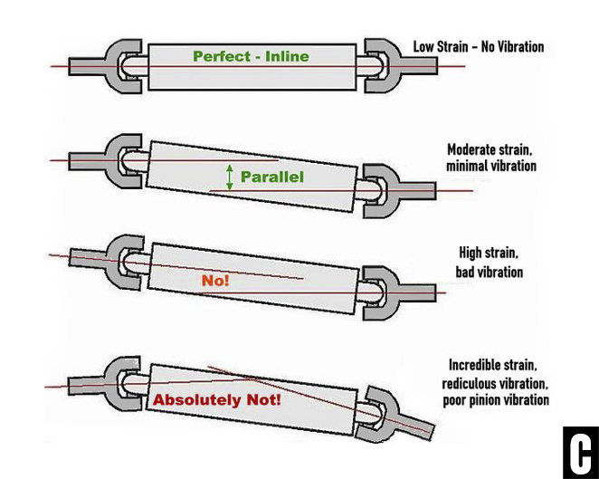

  27. Sharpone
    Joined: Jul 25, 2022
    Posts: 3,013
    Sharpone
    IMG_2905.jpeg Pinion angle needs to be adjusted slightly for axle wrap and vehicle loading however you want your driveshaft to be as near perfect as can be in normal driving
    Dan
  28. Ebbsspeed
    Joined: Nov 11, 2005
    Posts: 6,491
    Ebbsspeed
    Up on one end, down on the other. Up on both ends. Down on both ends. All are acceptable configurations for eliminating the vibration induced into the driveshaft caused as a u-joint rotates.
    @Sharpone the fourth example in your image is acceptable.
    If the angles at each end are equal, then the vibration caused at the propelling end of the driveshaft is cancelled by the u-joint at the propelled end. And it's not actually a vibration, but perceived as one due to the fact that the driveshaft speeds up and slows down twice per revolution due to the angle of the joint. I think by now we've all seen the video made years ago by ****er or some other drivetrain company showing this phenomena. If not, the video is at the bottom of my post.
    A "W" driveshaft configuration, while not normally practical, has identical capabilities to eliminate this "vibration" as a traditional "Z" configuration as long as the angles are equal.
  29. Sort of ... maybe ... ish.
    Engine trans 3 degrees down. Pinion nose raised to match the 3 degrees ... all is good.
    Now, take that SAME car and instead of swinging the nose of the pinion up, swing it down until you get to the "other" 3 degrees. I won't argue that they won't continue to cancel each other out BUT what have you just done to the angle of the U-joints? They are definitely not staying the same.
    Outback likes this.
