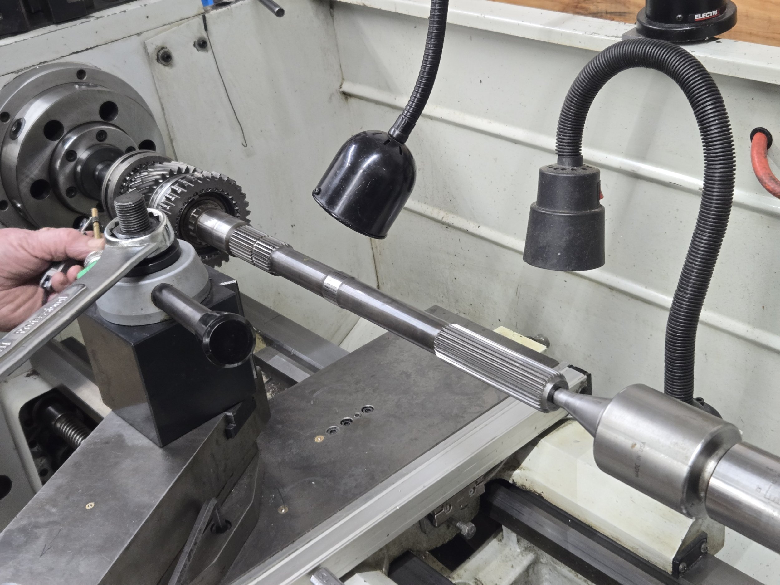

    Excellent advice everyone! The trans builder took the transmission apart today and measured runout on the lathe. The rear support bearing measured .006” runout. Considering the cantilever from the rear bearing to the output splines, I’d ***ume this is closer to .02-.025 at the output splines. This would likely be causing the damage I’m seeing to the yokes.
    The clutch engagement was actually really nice, I never had any complaints about clutch feel or engine RPM dependent vibration.
