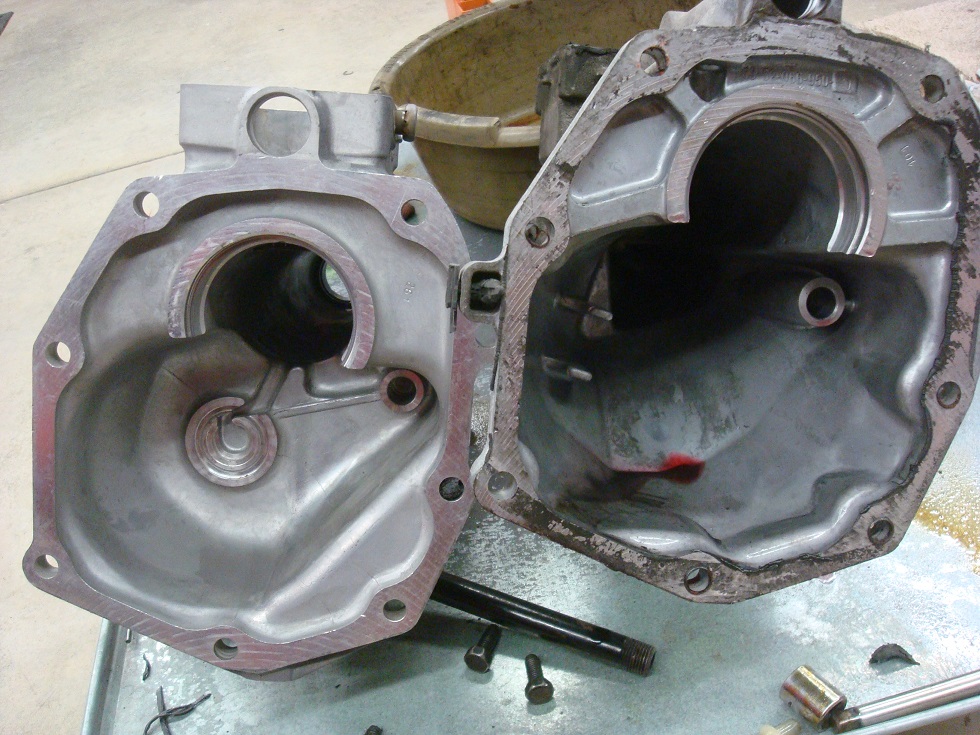

  13. big duece
    Joined: Jul 28, 2008
    Posts: 7,037
    big duece
    from kansas
    My '96 camaro tail housing did not have the provision for the thrust bearing and washer, on the counter shaft. Its compaired to an '89 s-10 tail housing. Can I run the '89 s-10 tail housing on the '96 camaro gear box? The funnels were both the same, so that's not the issue. Reluctors may have to be switched around too. 2015-01-03 18.54.14.jpg 2015-01-03 18.54.27.jpg 2015-01-03 18.54.39.jpg

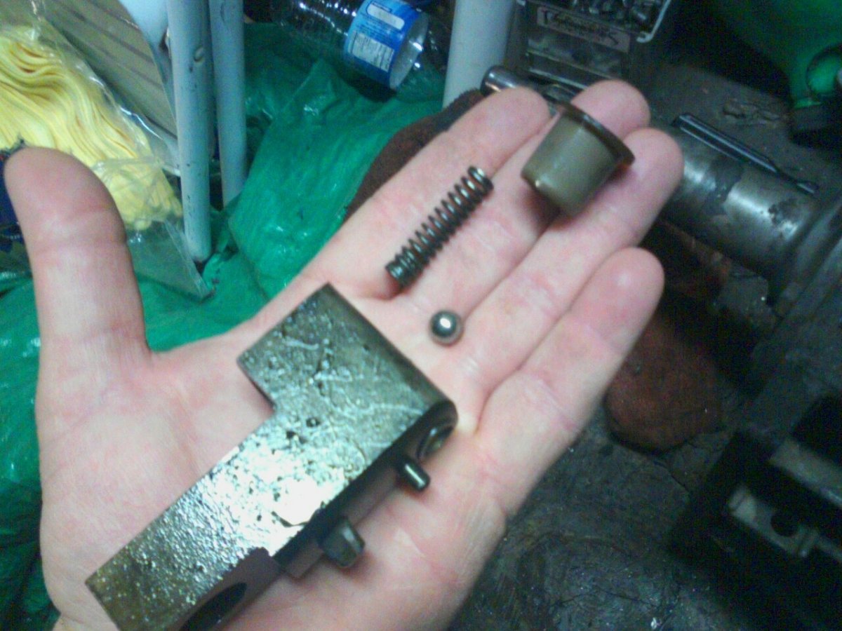

  22. Kato Kings
    Joined: Aug 22, 2006
    Posts: 707
    Kato Kings
    from Minnesota
    Is this the part you are calling a pocket block? If yes, then yes you need one from an s10 to do the tail housing conversion.
