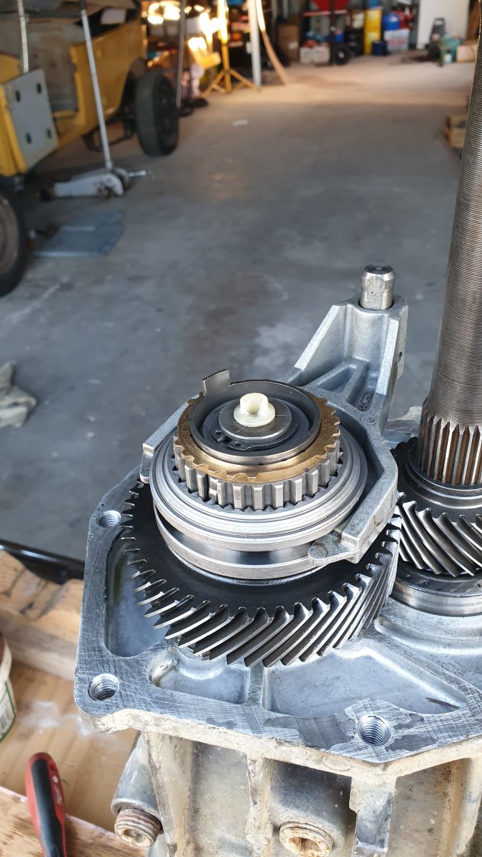

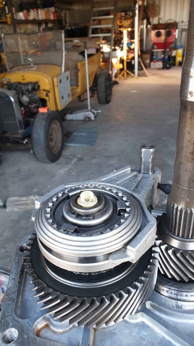

    I could not find an actual video of this swap but was not too difficult. Remove the roll pin from the fork and the circlip 20201107_185118.jpg 20201107_185121.jpg from the od unit.
    I found the easiest way was to keep the whole unit together from the synchro ring underneath.
    Helps with 2 people, 1 to hold it together and the other to move the fork. I will post a pic or 2.

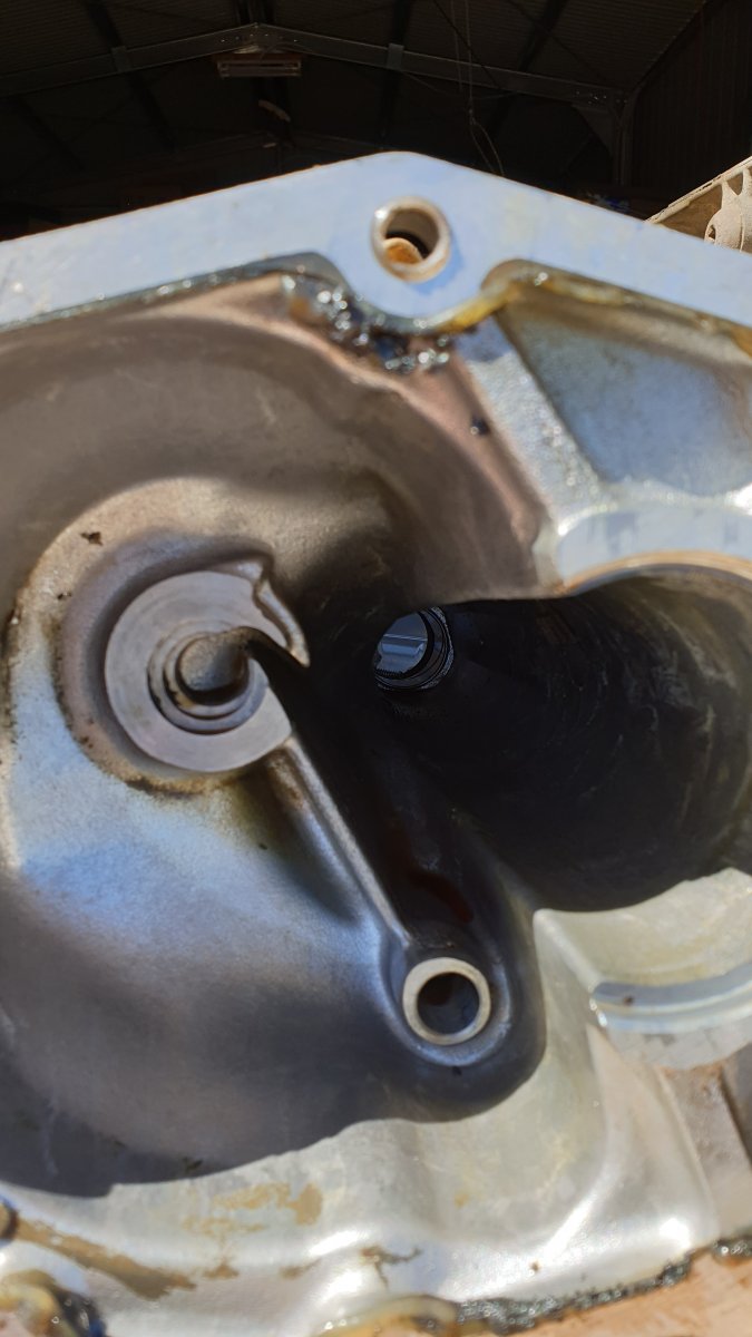

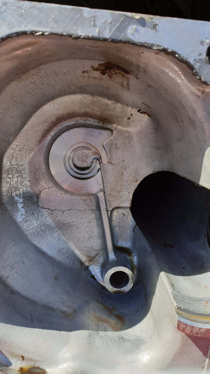

    The 2 extension housings, see the difference.
