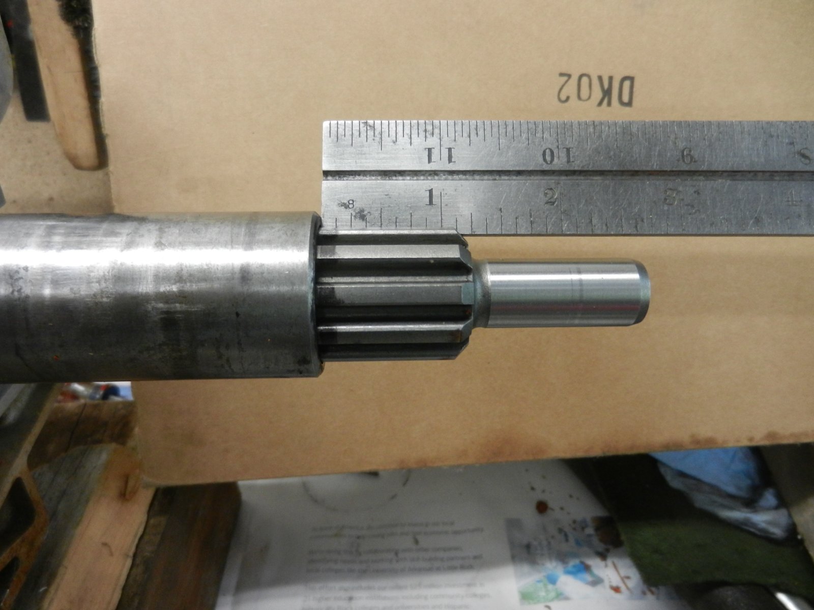

    When I put a '89 S10 T5 behind my 250 six, I studied the recommendation to use a Jeep 10 spline input shaft and shorten the nose and the bearing retainer. Glad I thought this through first, because that would leave only about a half inch of spline engagement with the clutch. Probably wouldn't shear with the meager power of a stock 250, but I was worried about uneven wear and the resulting poor dis-engagement. I opted to use the Vintage Metal Works spacer and took about 5/16" off the bearing retainer. With the Jeep 10 spline input shaft I now have a good 1 1/8" spline engagement and all 10 1/2" Chevy clutch parts. View attachment 5371637 DSCN7596.JPG View attachment 5371637 DSCN7596.JPG
