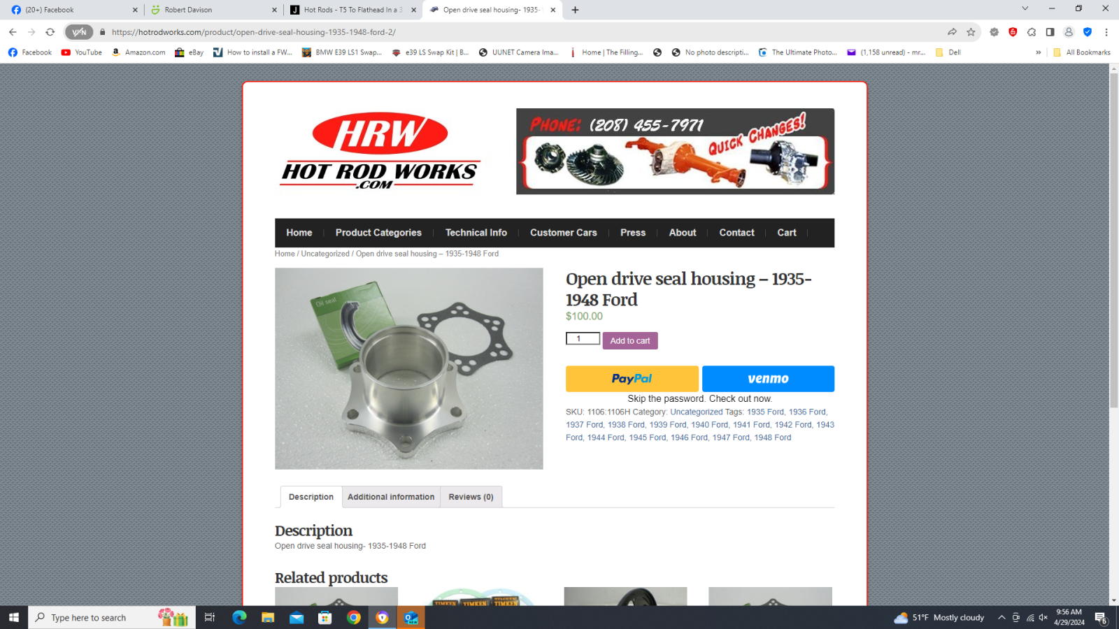

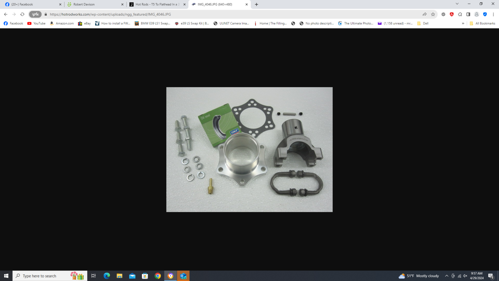

    The housing piece and the full kit show a seal in the original kits on the website so somewhere in the archives there is / are seal numbers. There may be a difference in six spline and ten spline pieces though.
    It may be faster to go ID - OD _ thickness and type of seal lip and material and hit the seal catalog at the bearing house. Probably a less than fifteen minute thing if he walks into a good bearing house with the two pieces. Screenshot (80).png Screenshot (81).png Screenshot (82).png
