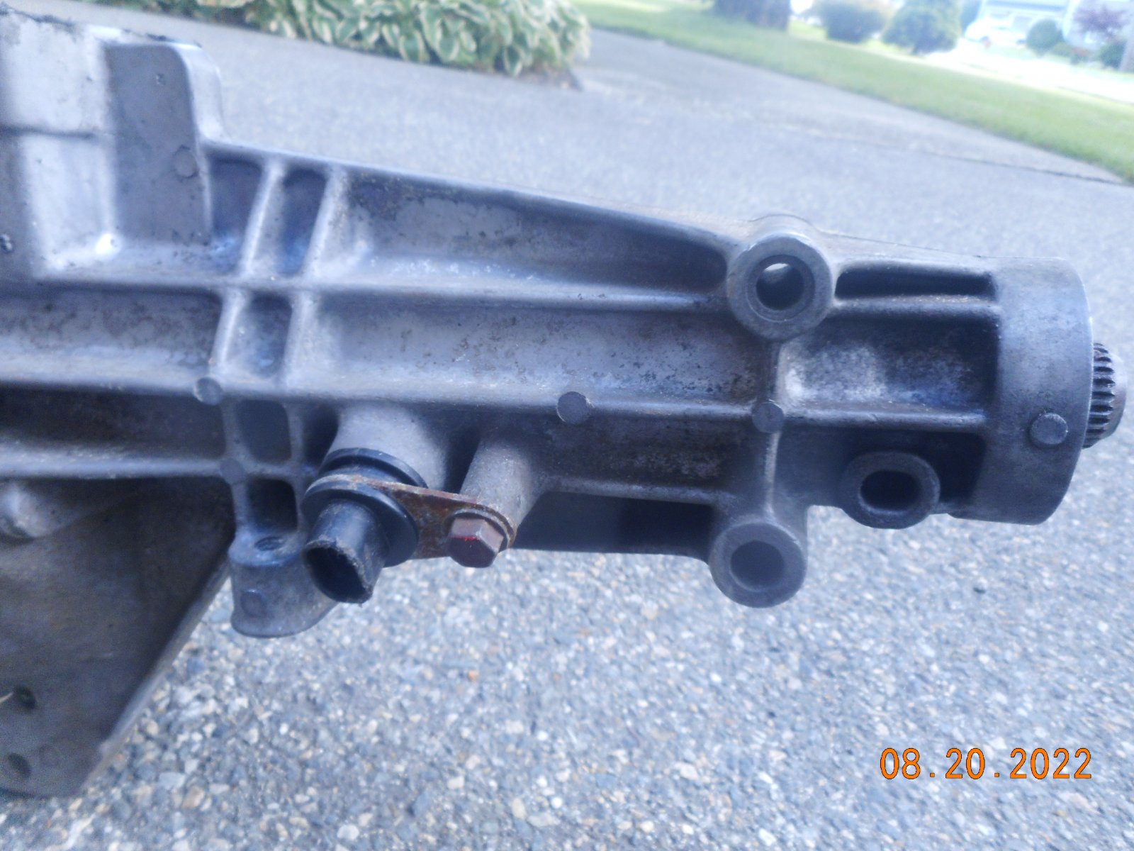

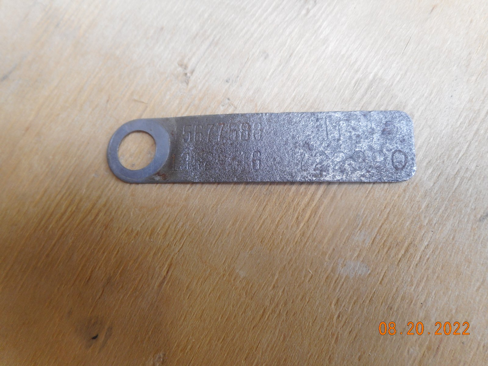

    Need help identifying my T5 ******.. It’s supposedly a 93-96 S10 with Ford front bolt pattern.
    The best that I can read the tag is –1352216 or 1352246
    Attached are some photos.
  2. Shifter location looks like Chevy S-10/GMC S-15

    It is a 93-96 S 10 trans.

    GM 1993 MY 2.2L S-Truck WC
    R3.76 1st4.03 2nd2.37 3rd1.49 4th1.00 O/D0.76
    Around that time GM went to the Borg/Warner Ford flange pattern.

    That is a world cl***.

  10. It is WC, Annnd, if you can find one, AMC used a Bellhousing that had the Chevy BP on the Front and the Ford BP that that ****** will bolt to. I happen to have one here. They were in CJs and I think Eagle wagons

    That year range only had the 4.03:1 ge****t. There were no other ratios in the S10/S15 with that combo, as far as records show.
    The Ford pattern in a GM vehicle was end-of-model-line.
