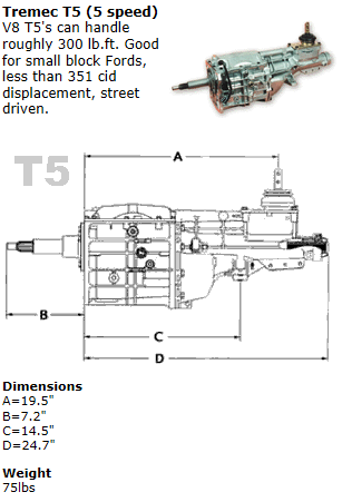

    Are the Tremec 5 Speed boxes physically the same size as the BW T5 ?
  2. brsturges
    Joined: Oct 22, 2008
    Posts: 1,006
    brsturges
    from Miami, FL
    Yes, but all I have seen have the “Ford” bellhousing bolt pattern on the front, while some of the BW ones have the “Chevy” bolt pattern.
  3. Bandit Billy
    Joined: Sep 16, 2014
    Posts: 15,958
    Bandit Billy

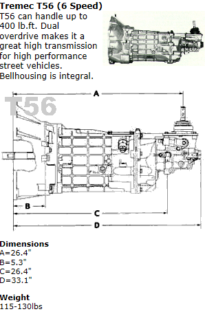

    Here are 3 ******s for ya, T-5, 5 speed tremec and the 6 gear box.
  4. Deuces
    Joined: Nov 3, 2009
    Posts: 26,682
    Deuces
    I think the new Mustangs come standard with the T-56..... I could be wrong...
