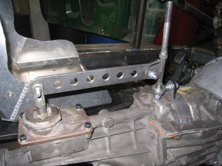

    That won't move the shifter further forward of what a stock S-10 shifter is though, It just moves the Mustang T-5 shifter up to where the S-10 shifter normally sits for 750 dollars.
    Look at post 4 and study it a bit. Technical - T5 shifter position forward | The H.A.M.B. (jalopyjournal.com) Similar linkage has been used in various cars for years when the trans isn't in the right spot to have the shifter work right.

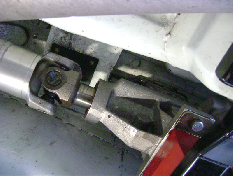

    My O/T Racecar [Mustang FR500C] has a similar method to move the lever rearward . This was done at the factory
    It would work exactly the same to move the shift lever forward [you only need tunnel clearance]
    If anybody wants to think outside the box.
    A Ssangyong Musso used a T5 with a rearward shifter
    This could be bored through so the shift shaft can poke out the front [and the shaft turned around 180° and new roll pins drilled for the offset lever]

    Great info and thanks to all. That Ford MTC shifter reversed would probably work but to get one. Any ideas where to locate one? 48 chev that flatbar a spherical joint looks like it would also work. I can`t believe that Speedway or someone has not engineered a bolt on kit by this time.

    I actually could use 2 and a 3rd for a buddy`s project. If I can lower the flat bar and locate the spherical joint, I believe with the S10 tail and maybe shallow tunnel/channel in the ****** floor cover, it should work. I imagine the flat bar as a shaft would have the most clearance like the dog bone shape of the FR500 shown above.

    Instead of the MTC shifter , make one!
    Understand the geometry is "an imaginary straight line" between 2 pivot points [the bar in between can be bent around things for clearance]
    You could mount the actual shifter higher up in the tunnel [or on the inside of the p***enger compartment] AND use a "J" bar shape for the shifter shaft.
    You can also alter the leverage ratio at the shift lever [for quick shift] This only alters the north/south movement not east/west [which is degrees of rotation]
    You need to retain the stock shifter on a T5/T56 because the Belleville washers in them are needed to centralize the shifter in the 3-4 gate. [just cut and mod the lever]

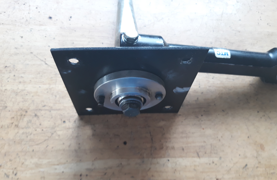

    Here is some more photos of the MTC shifter [showing a spherical bearing instead of a heim]
    The shifter was bolted to a plate welded into the tunnel
    The cross-bar pivot on the lever needs to be narrow enough to fit inside the top shifter "hole" for ***embly
    On this shifter the Tabs can be opened and the lever turned around 180° to face forward
    Top view

    They sell these setups to tighten up the shifting on a Mustang T 5 for 30 something bucks on Ebay. Maybe not the high zoot thing but for the purpose it will probably do fine, Cut the ball off the bottom that is used to work the shift rod on the T 5 in it's normal configuration, make a mount bracket to set it exactly where you want it and fab the link like Kerrynzl showed in his bottom picture and you are set. There are a ton of them for sale so ou just pick the one you like the looks of. T 5 quick shift top.jpg Mustang quuick shift (2).jpg
