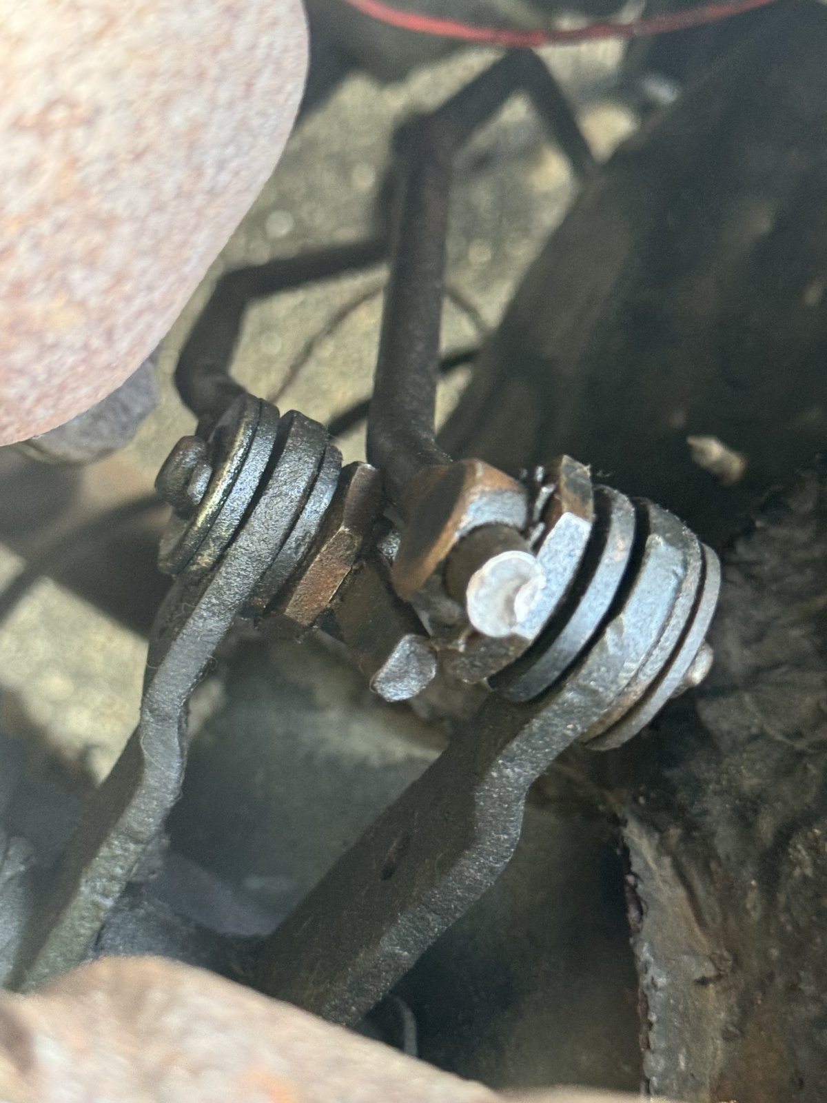

    I did get under the car tonight and verified the arm on the trans was fully engaged when the gear selector is placed into 2nd. The linkage does make slight contact with each other in this position but it’s pretty light and even with the 1/r linkage removed, it doesn’t change the 2/3 engagement at all.

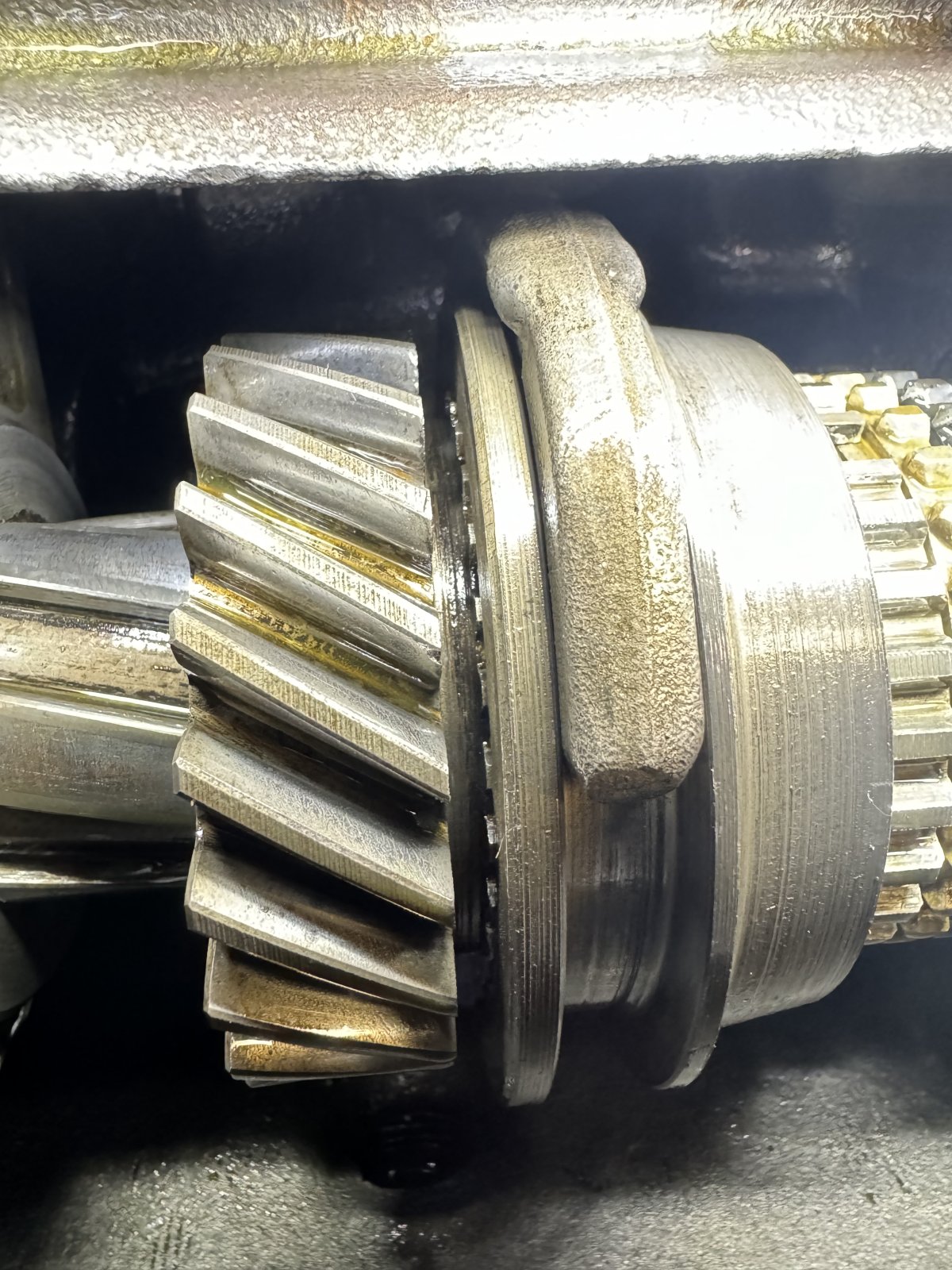

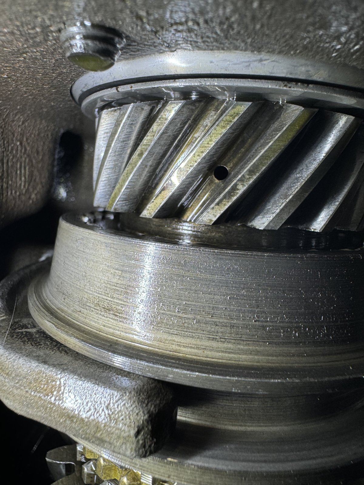

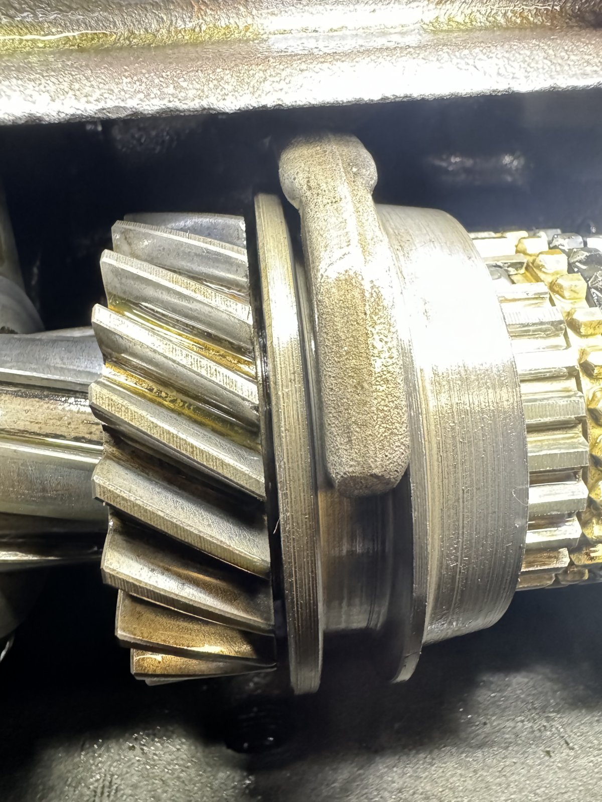

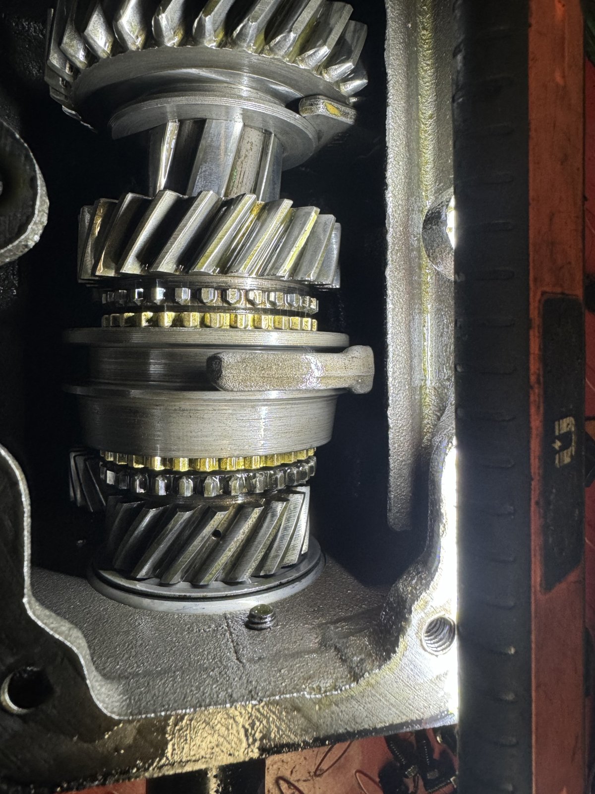

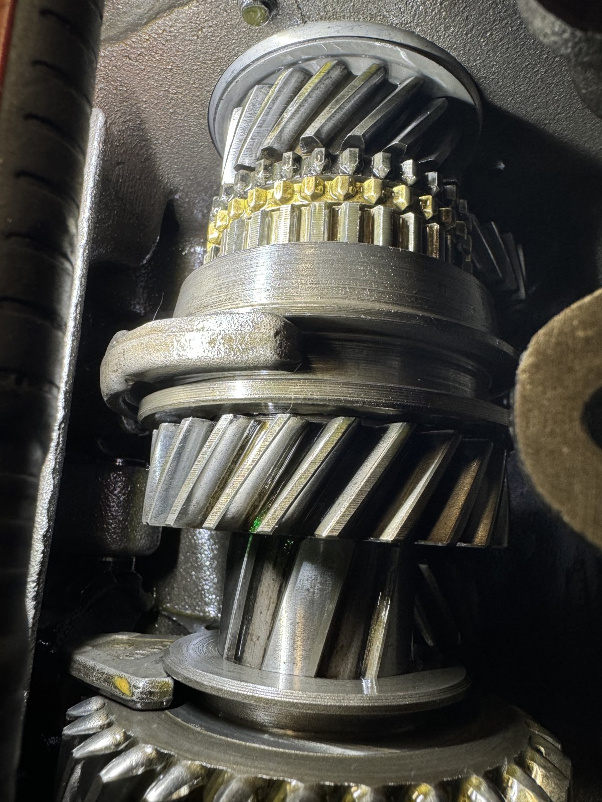

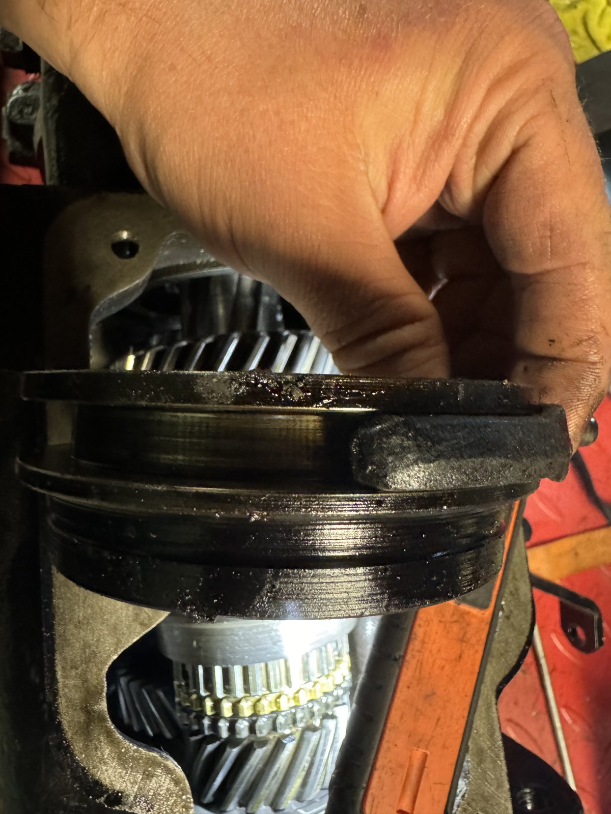

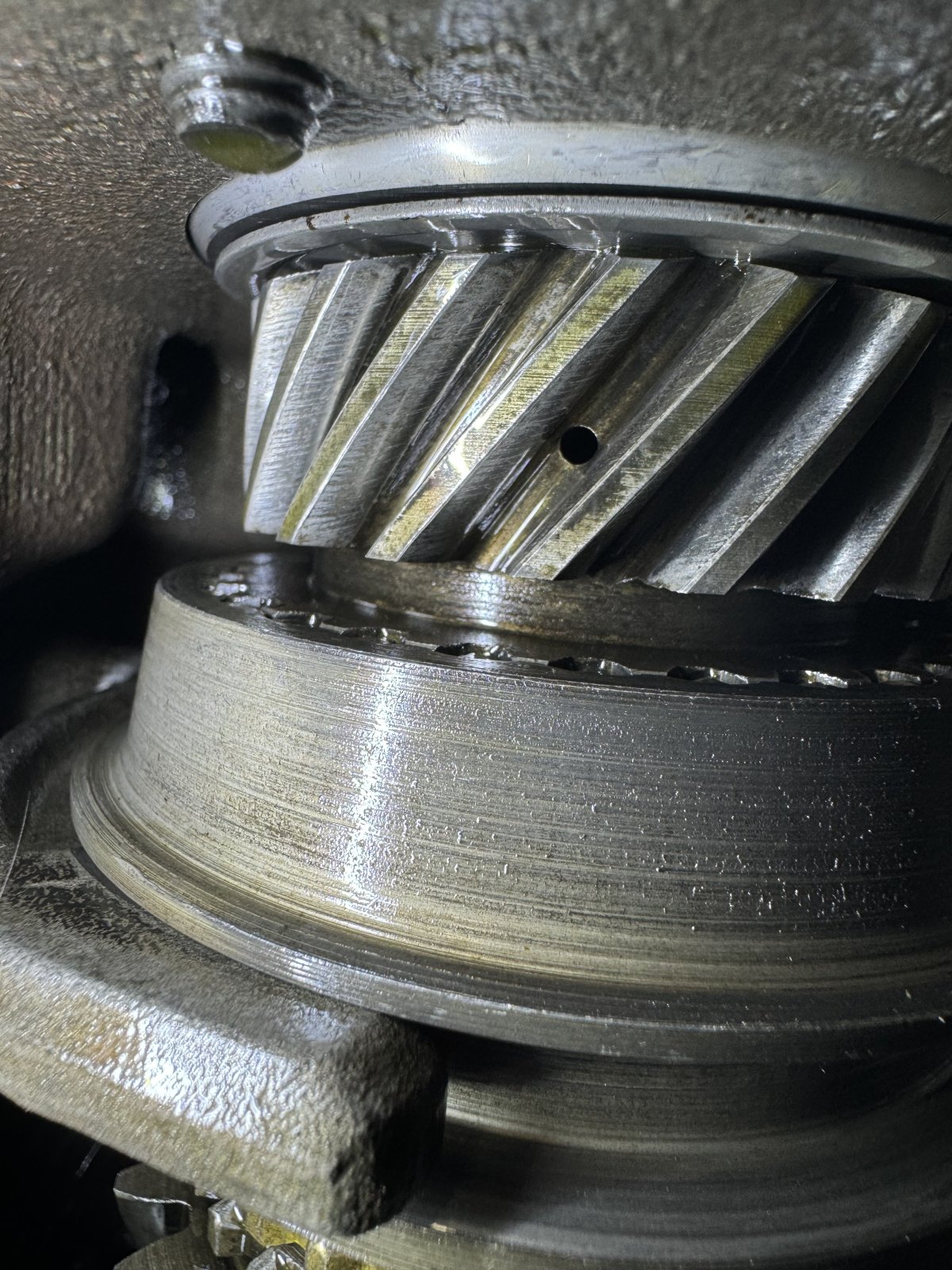

    Well guys think I found the problem. The fork for 2/3 allows for far better engagement between the sleeve and the input shaft then it does between the sleeve and second gear.
    Appears the cause is slop between the fork and the sleeve, however I don’t think either part is worn, I question if one of those is just wrong.
    I dug though my parts bin of a newer t86 (used to many different parts to be a perfect parts donor) and grabbed the fork out of that and it is much wider and shaped ever so different. Looks like I’ll be tearing it all down to replace the fork .
    klleetrucking likes this.

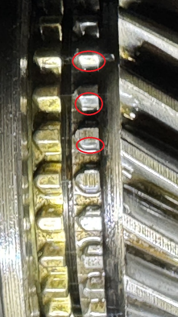

  15. Rodney Dangercar
    Joined: May 19, 2024
    Posts: 92
    Rodney Dangercar
    Yup. If that fork wasn't moving the slider into full engagement then there might be some additional wear.
    ETA: I just realized that pic is from your trans. You got another problem to deal with there. Ouch...
