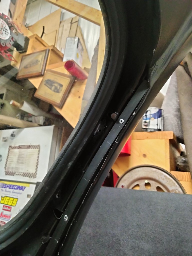

    Wanted to include this picture in my previous post; but couldn't find it then. Here is that PVC trim board material used as a windshield pillar tack strip in our '47.

    Not present in this picture; but I used screws to hold the metal end covers for hidem welt after the upholstery was stapled.
    While that was a low stress application, the material is pretty dense and the screws bit in and tightened down fine. .
    I cut these strips on a table saw, rounded the top edges on a router table, and formed the bends with a heat gun.
    I also cut some long 1/2" x 1/2" strips and put them in the tack chip channel all the way around the doors on my '35 3W and used some 1/4" x 1/4" strips around the inner groove of the top opening.
