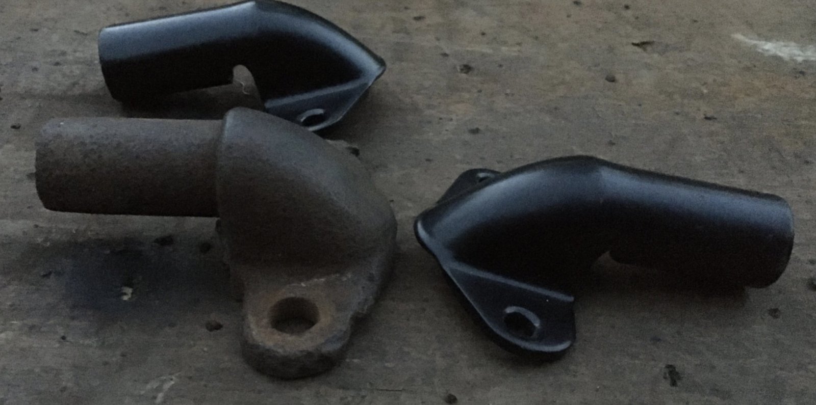

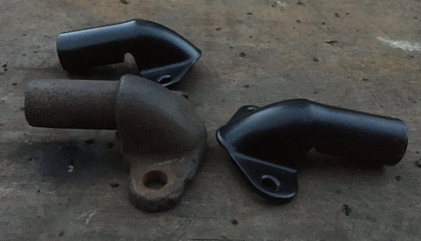

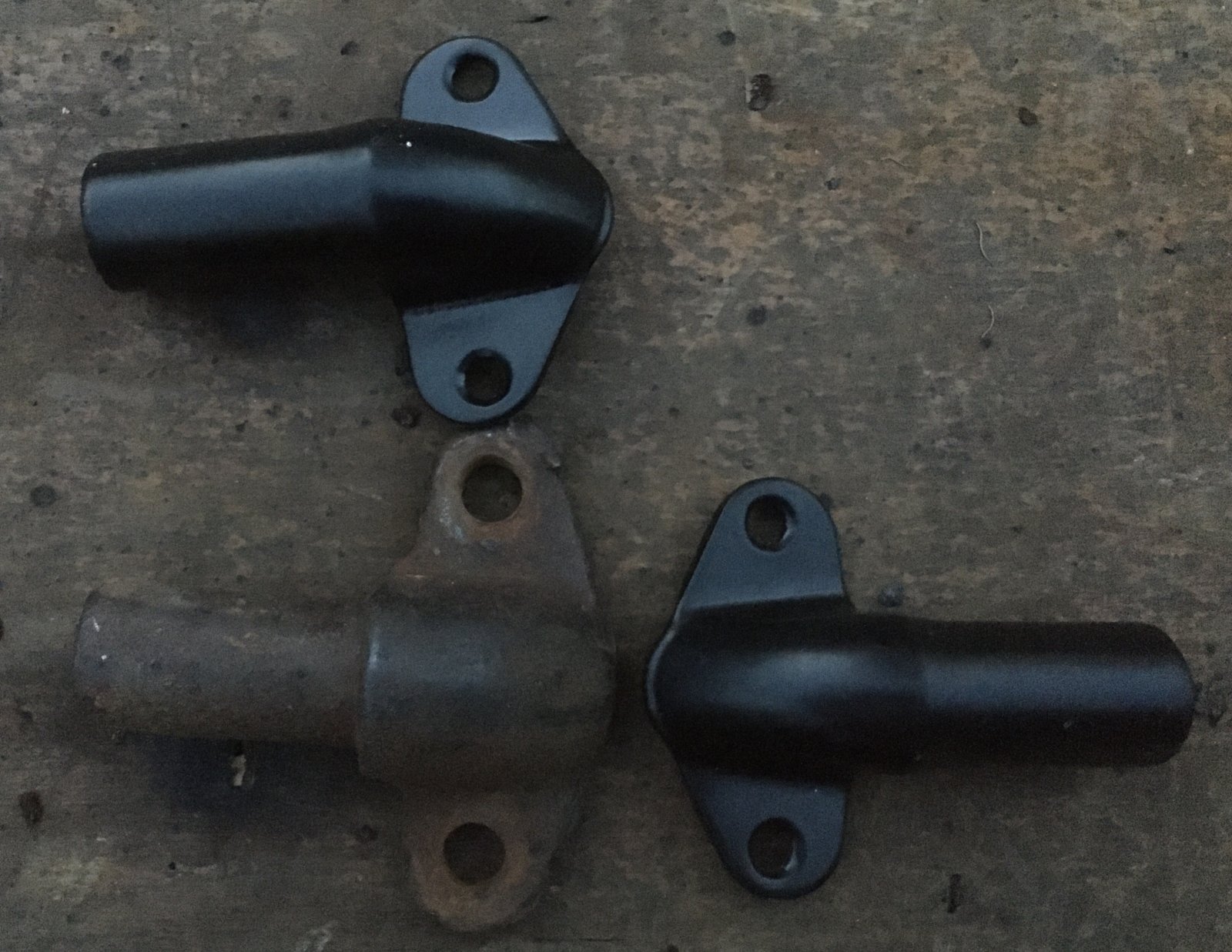

  12. ActionYobbo
    Joined: Mar 28, 2022
    Posts: 356
    ActionYobbo
    Repro hinge has a 2 inch bolt spacing with quater inch holes. The old hinge has a 2 and a quater inch bolt spacing and 3/8 holes.
    I have a truck the gas tank is under the seat. I think there is a difference in the parts used for the light weight pickup and the heavier truck like I have
    edit to add. I think I am finding out the hard way that there is a difference in parts based on where the gas tank is. I just got some more dainty undersize parts in the mail. Starting to look like sedan pickup parts are 2/3 the size of truck parts.

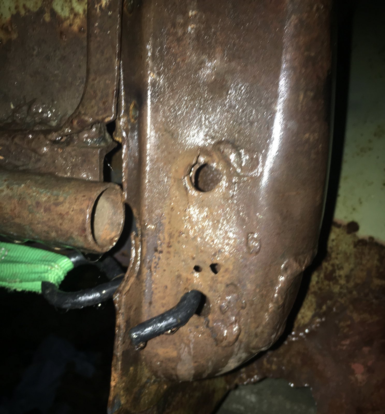

  14. ActionYobbo
    Posts: 356
    ActionYobbo
    Tried to get some pictures tonight in the dark with heavy rain but they are all out of focus except this one that shows the bolt holes for the hinge.

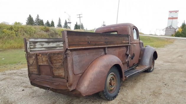

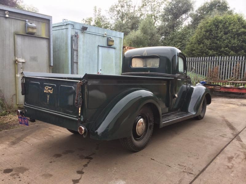

  18. ActionYobbo
    Posts: 356
    ActionYobbo

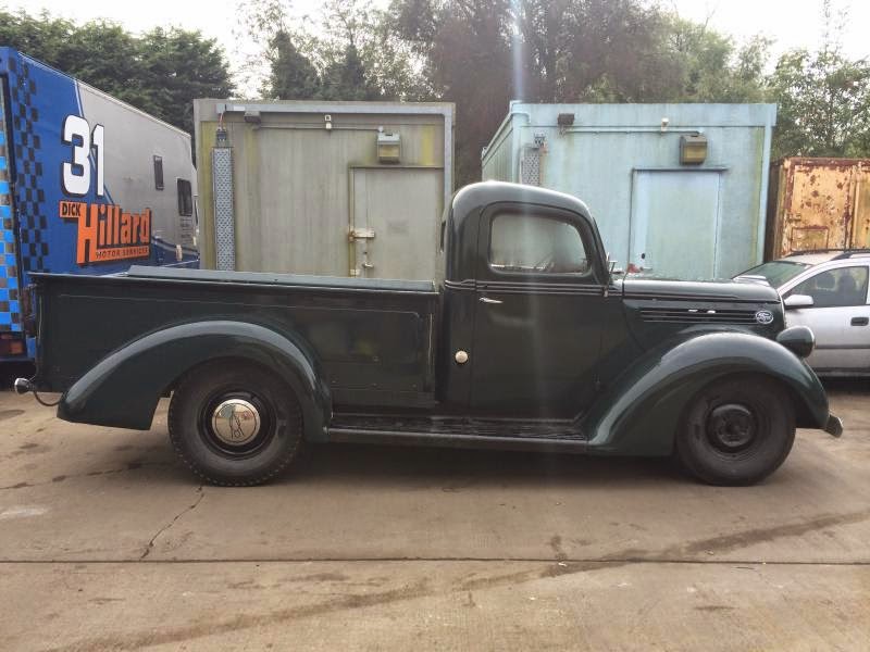

    here are some pictures I found on the internet. My truck is a 39 1 ton that started out as a cab ch***is I managed to find a bed for a 1940 I ton which I am currently in the process of straightening and fixing the rust so its pulled down to separate panels now The only difference between a 39 bed and a 40 bed is the center stake pocket. Anyhow here is some pics of a 1940 1 ton so you can see the 1 ton bed and a 1939 1 ton so you can see what I am building

    It looks like the one ton truck has very little in common with the p***enger car based pickup.
    Also, there is no one ton specific aftermarket parts.
    You will have to fabricate a hinge, or modify the standard pickup hinge, to work with your application.
    Maybe something off another brand heavy truck could be adapted?

  23. Bandit Billy
    Joined: Sep 16, 2014
    Posts: 16,224
    Bandit Billy
    These are the hinges on my 41 ford bed. 2 1/4" spacing and 3/8" holes. The also have a more pronounced lip that the gate rides up to like the one in your picture above. The small hinges don't have that I notice.

  26. Johnny Gee
    Joined: Dec 3, 2009
    Posts: 14,467
    Johnny Gee
    from Downey, Ca

  30. Johnny Gee
    Joined: Dec 3, 2009
    Posts: 14,467
    Johnny Gee
    from Downey, Ca
    The thickness of the flange. Resembles that of a thermostat housing as well. Or is it just me?
