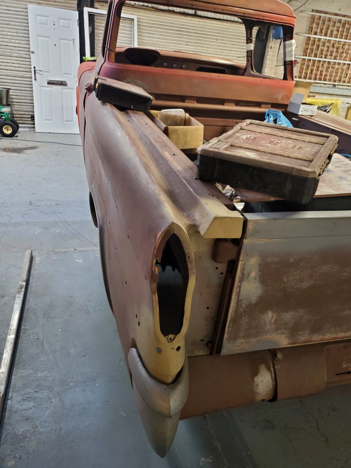

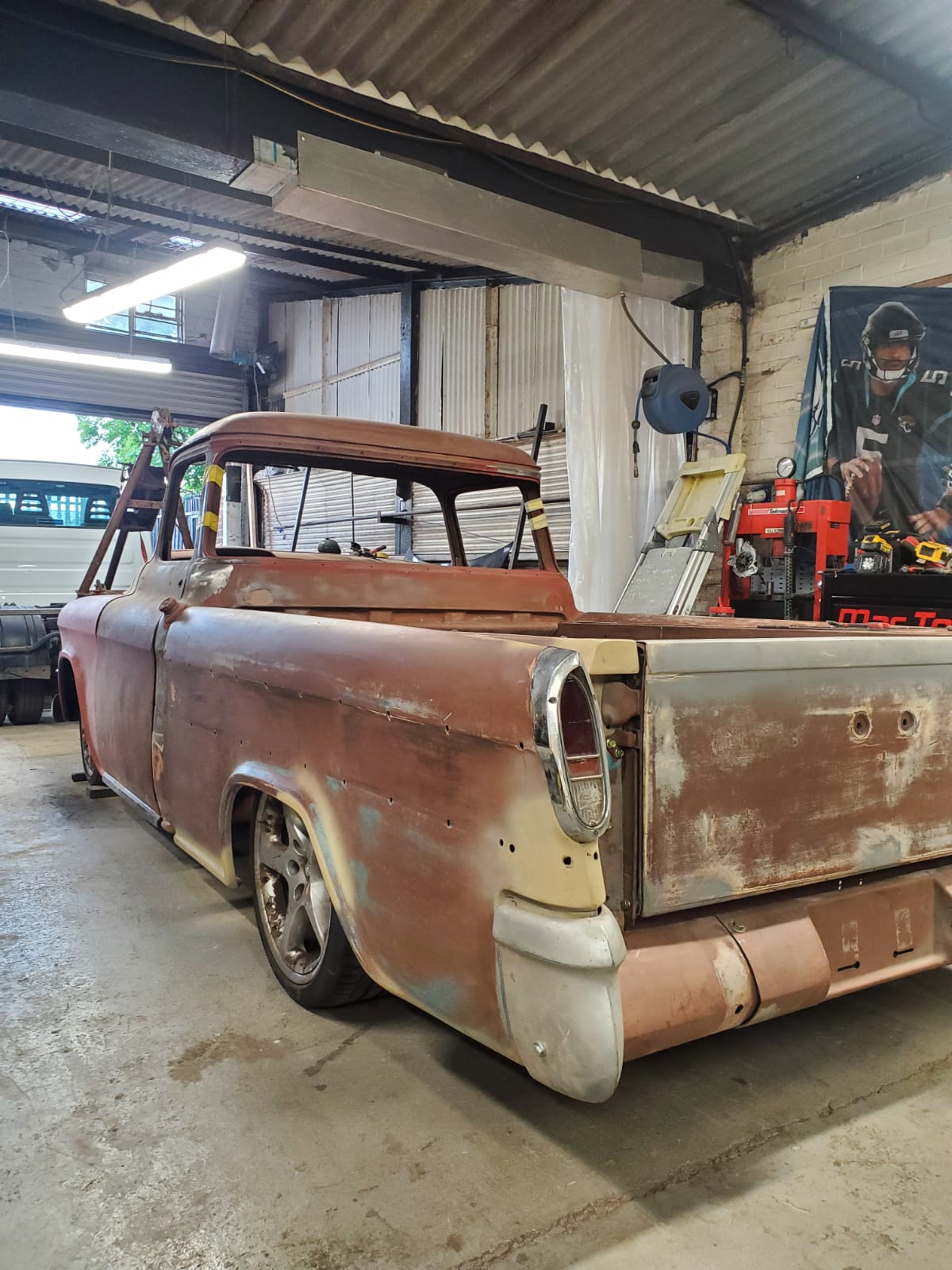

    I’m looking to put the gas filler in my 57 Chevy cameo truck behind one of the rear lights to shave the filler.
    does anyone know of a kit or way of doing it that’s neat? Anyone done it on a cameo?

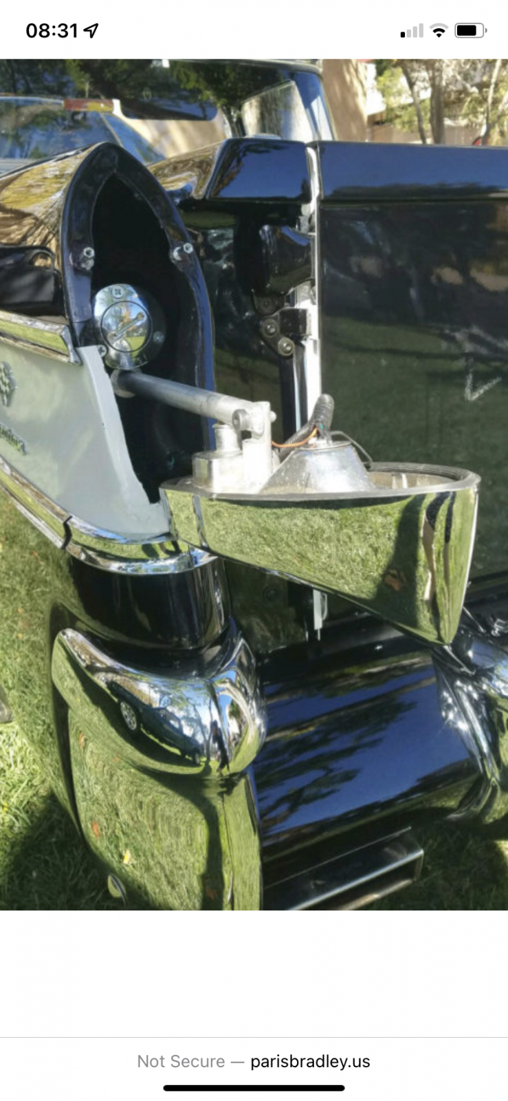

  8. Jasper234
    Joined: Oct 11, 2011
    Posts: 83
    Jasper234

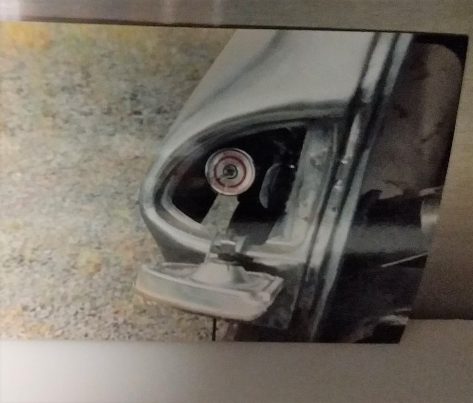

    I want to take the tank out of the cab and put something under the bed ahead of the rear end. It’s having a c4 rear.
    I’ve just found this picture online and currently trying to figure what it is and how it works!!
    Johnny Gee likes this.
  9. BJR
    Joined: Mar 11, 2005
    Posts: 11,084
    BJR
    If you blow up the picture it looks like a linear actuator moves the tail light open and closed. Thats how I did it on my 49 Buick.
