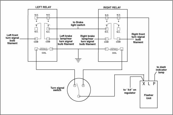

    You need to run someway to cause the turn signal to function at the same time the brake lite is operating. I copied this from somewhere on the web, might even have been here can't remember but it works. You can use a spdt switch mounted in dash.

    I do think it is possible to do with the correct filaments wired, as stated previously.
