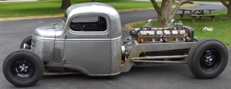

    Your request has been done before. A guy from Baltimore built this cab over a few years ago. He used a TH425. Since the TH425 runs backwards, he had to put the engine in backwards ( note the bellhousing up against the back of the cab ). He made an adaptor where the normal differential bolts on that included a TH400 tail shaft. It seemed to work well. He also used a quick change rear so he could flip the ring gear o everything works correctly.
    I have a TH425 in my sbc powered 65 Corvair. I do have the name and phone number of a place in California that does a lot of different gear sets along with posi and spool carriers pats truck.png

    And that is what was said about the unit on the truck above. An adaptor was made to allow a TH400 output shaft to be used into a 2 piece driveshaft
    The output of the TH425 is a short splined shaft ( maybe 3 inches ) that fits into a splined female pocket in the differential. It would not take much to turn the output to a standard splined shaft...….some simple machine work would do the trick.
    Even a Corvair engine runs backwards along with at least half of the marine engines in boats regardless of displacement
