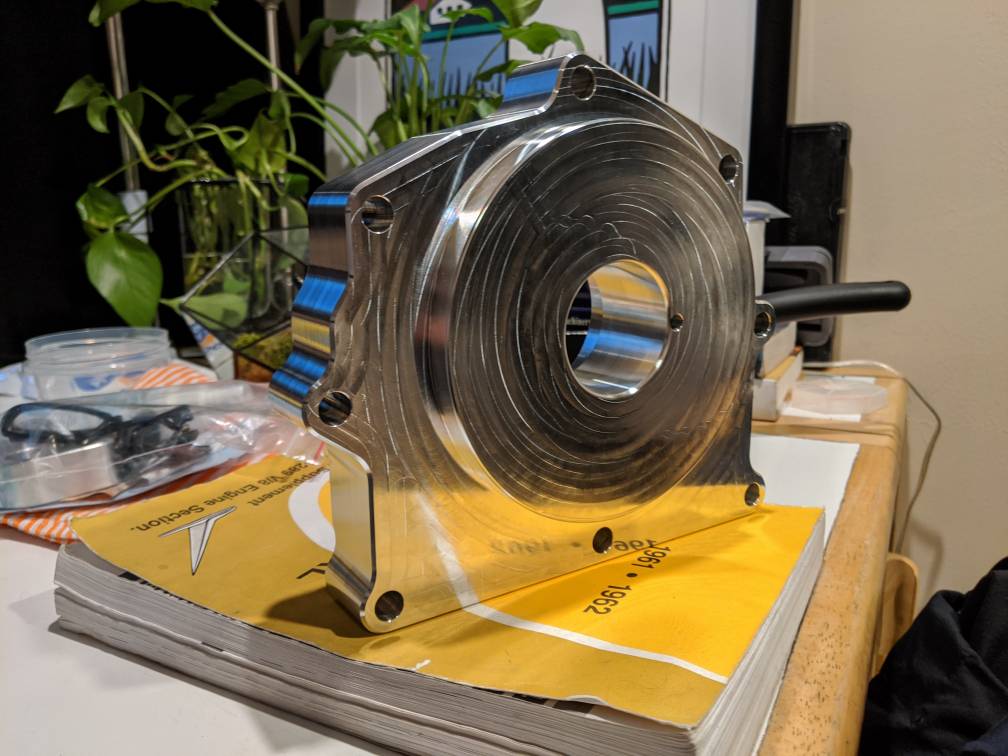

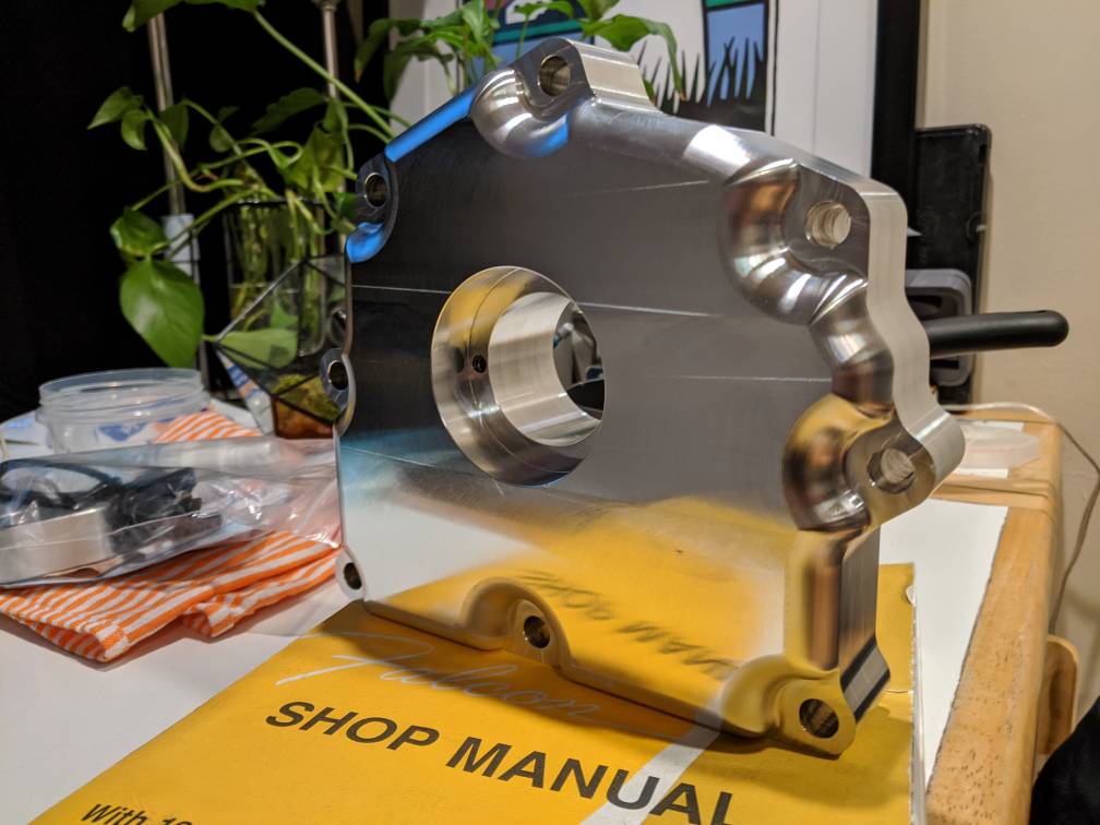

    Here is the "smoother" design, as produced, in 6061-T651.
    It takes an OEM bushing, seal, and gasket, straight from a TH400. IMG_20200717_191506.jpeg IMG_20200717_191520.jpeg

    That is a thing of beauty. Please keep posting showing the Transmission to QC connection.

    squirrel
    Nice looking part.
    A bit of sandblasting, and it could almost look like an old sand casting, eh? But if it's a show rod you're building, I expect you're polishing the transmission case, as well :)

    How much? We're talking Jay Leno money.
    This is not currently a saleable individual product, and likely cannot be.
    Firstly, using one requires a second TH425 output, to act as a donor for the governor drive gear. Harvesting that portion of the output is a very difficult machining process to do properly, as it, and the turned-down shaft that it must be interference-fit to, are both hardened steel. I am down to my last two gears, having ruined the rest, along with a pile of tooling in developing the process. These parts are nearly impossible to find loose, and require a whole transmission to harvest one. Those go for about $500, delivered.
    Secontly, there is zero market for these. The long and the short of it is that there is no way to recover the sunk cost in designing these, let alone reproducing them. I have to pay myself, my staff, buy materials, and cover other overhead.
    The only way that this was viable to do as a two-off (soon to be 3, and then done), was to have them be part of a whole-car build, and bundled into that price.

    If I had to do this over, I would make a custom shaft that fits where the pinion plugged into the transmission.
    It would be more expensive overall, but a lot less work.
