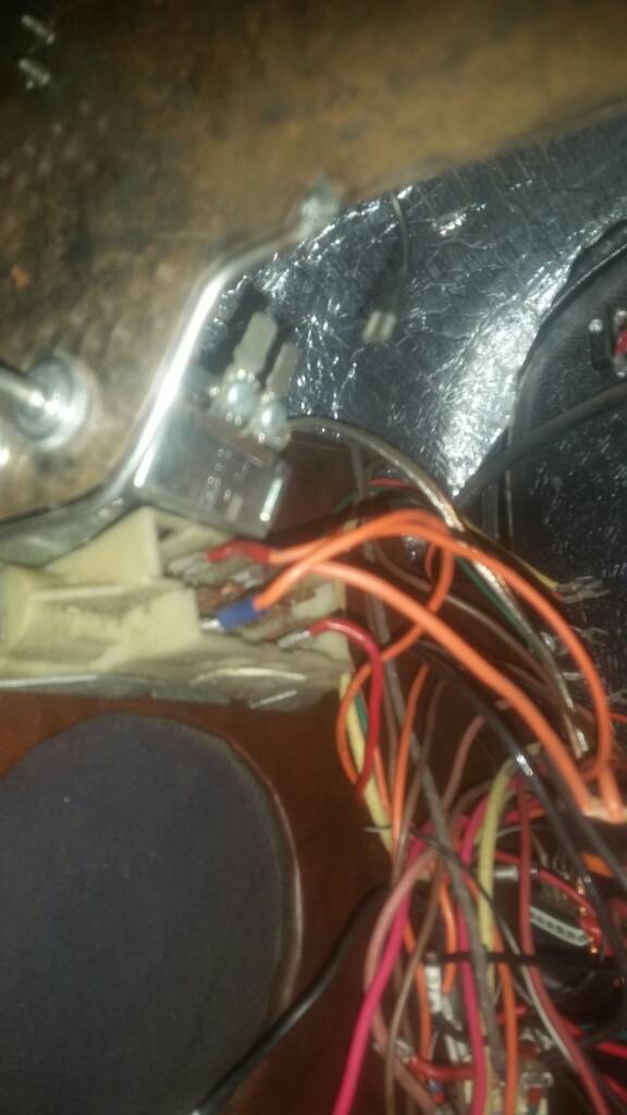

    In my time as a tradesman over the last 15 years, i have had the pleasure of working on quite a few hot rods and street rods and the all seem to have very similar issues. The wiring woes! I am dual qualed in mechanical and auto electrical, so i have gotten myself into some pretty nightmarish diagnostic probs.
    Now i really enjoy wiring. It is the part of the project that is seldom seen but can be the difference between trouble free enjoyable driving or sitting on the side of the road waiting for a costly tilt tray or a friend with a bit of spare time. Not to mention the frustration of headaches trying to delve into wiring harnesses.
    So i thought i might put up some helpful tips that i have learnt over the years.
    Ground points! I cant stress this enough. Clean ground is essential. Always remember the more gound points are better. Electricity is for the most part, fairly lazy and will always find the easiet path. So more grounds mean less issues.
    Connectors. We have the Internet now. So getting new connectors are easliy available and fairly inexpensive. Water proof plugs are very handy and now getting very small and easy to use.
    Education. Take the time to do a night cl*** or similar. You'll be surprised at how much you can learn.
    Extra cable! If you it's the correct length, give yourself a a few more inches. Cable is cheap. Use new stuff. It doesn't have corrosion and will always solder nicely. Spend the time making the harness uniform and tidy.
    Plan ahead. Think about what circuits will be placed in which part of your project. I hate having to add wiring in to a new neat harness. Think about where heat and moving parts will be.
    If all else fails, jump on here and ask. Electricity is mostly invisible. There are many people on here with quite an expansive knowledge of antique wiring systems.
    I hope this go a little way to hepling everybody with their projects.

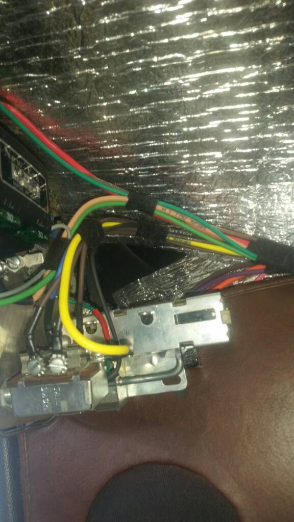

    Here are a few pics of a coupe i recently rewired for a friend. I found 5 circuits that were unfused and some wiring that was squashed between ch***is and body! Dangerous stuff. Some before and after pics.[​IMG][​IMG][​IMG][​IMG]
