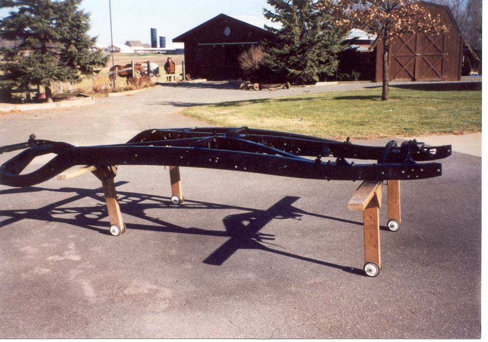

  17. 38bill
    Joined: Dec 20, 2019
    Posts: 195
    38bill
    from Minnesota
    Did you build that nice little cart under the frame? Mine was a very crude in comparison. If your doing a wood bed and need some info let me know as I made drawings with dimensions when I built mine.
