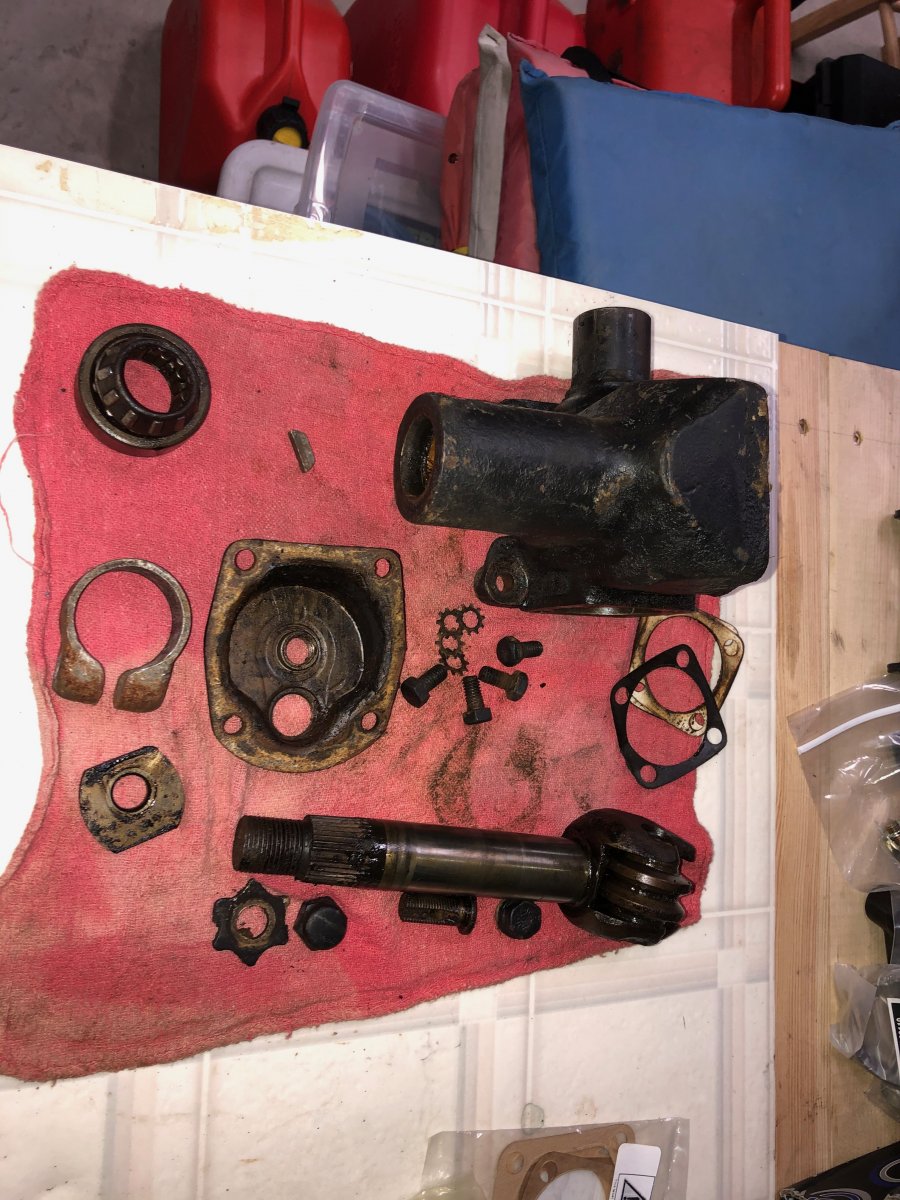

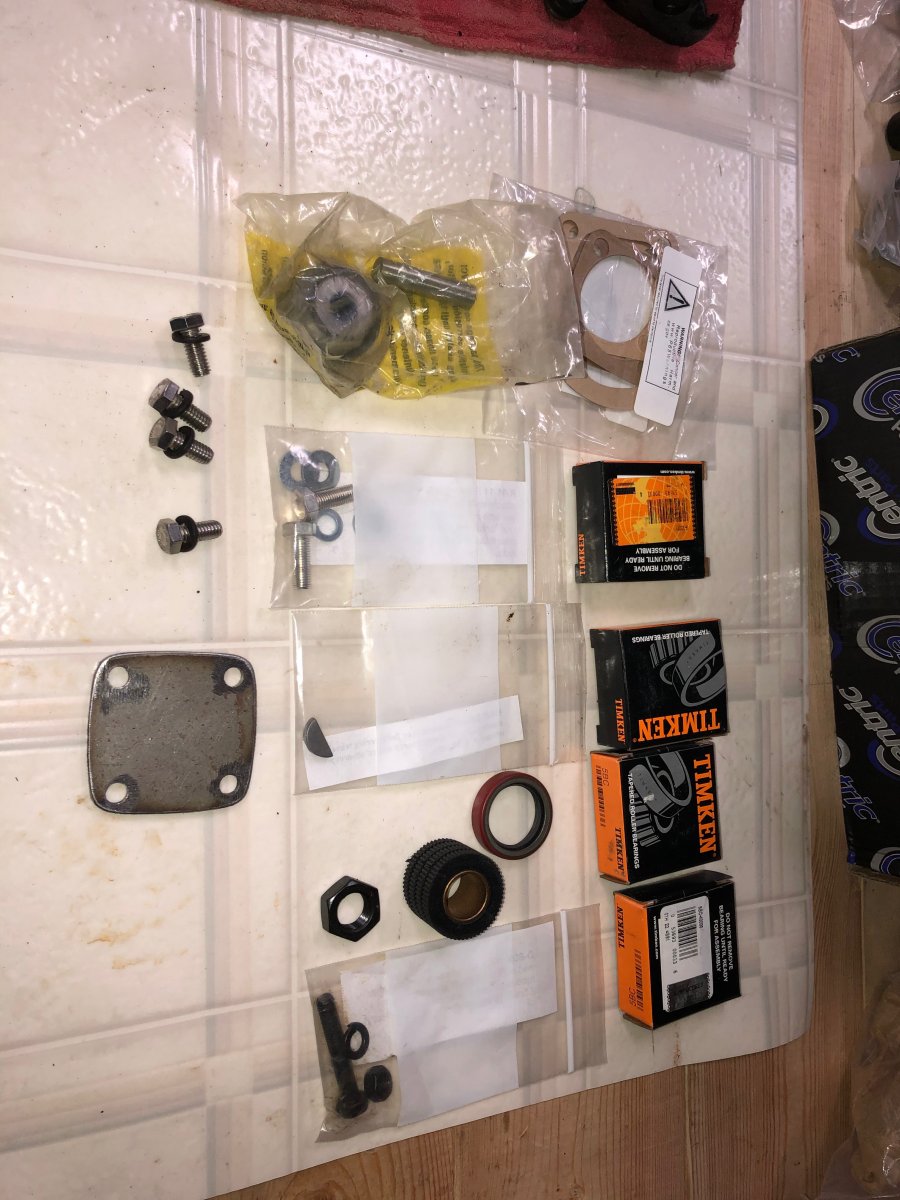

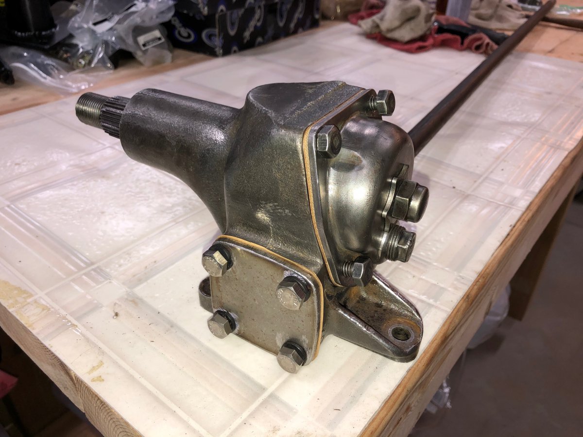

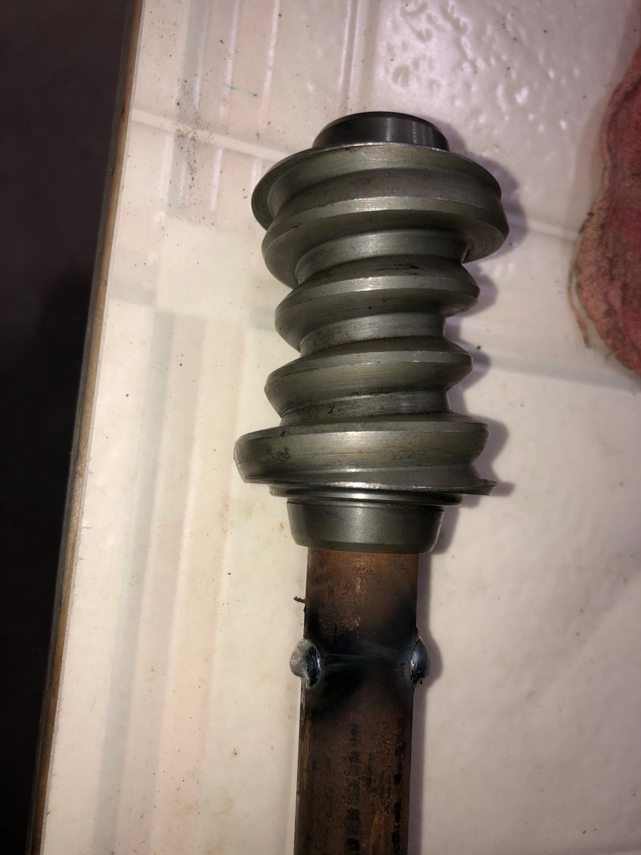

    I am using a 1939 Ford Steering Box (the one that came with the truck) and installing a new worm and sector with new bearings.
    The original steering shaft had more twists and bends than I cared to have so I contacted a local Old Ford restorer who sold me one out of a 1936 (it was NOS). The worm was wrong but it had the same shaft as mine, so I simply popped of the old Worm and tapped my new one on in its place... more lies... it wouldn't budge so I broke down and took it to a machine shop. They managed to do the swap but... apparently it was a "beeatch"!
    All back together now - just needs paint.:)

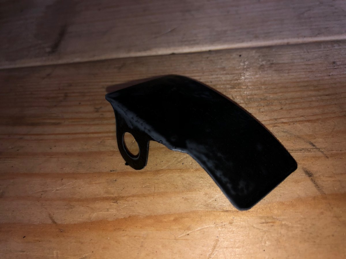

    The pan I am using appeared to have had the baffle removed (not sure why, but strangely I have a second pan, identical, and it had the baffle removed as well???). In any case, I don't like the idea of engine oil rushing up to the "nose" of the engine every time I hit the brakes, so I fabbed up a replacement baffle out of some sheet metal and welded it in...
    I also made a timing marker at the same time...
    Now I have everything painted and test fitted so I can go ahead and ***emble the drive train once the transmission is indexed

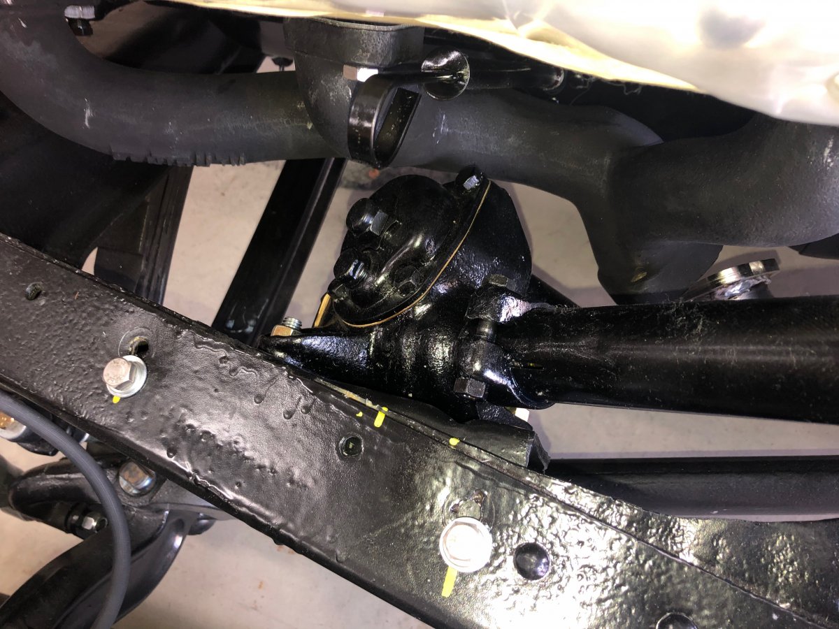

    For the trial fit, I had to mark on the crossmember where it needed to b trimmed for the T5, which is quite a different shape than the original - this is something I knew I had to do, so when the transmission was out I had made a cardboard template showing where to cut.
    There was really only one other issue... the Fenton Headers interfered with the steering box (which is stock).
    It was clear that it needed "adjusting", so I pulled the engine back out and moved the steering box mounting plate about 1/2" in on the frame.
    there is plenty of clearance now and the second time, the engine slid into place nicely.
    I Next I will set the pinion angle on the rear end.

    Any chance of cookin' the grease in the steering box without a heat shield?
    I'm curious 'cause my headers & steering box will be about the same and maybe I need to install "an ounce of prevention"...

    Can you post a photo of what you have to trim for the T5? I didn't trim anything on mine. Just cut rivets and removed the stock center section. I replaced it with a CE center section but you could make your own if you wanted. Whatever you do make sure that the drive shaft angle can be aligned properly to the rear end.

    I'm not using grease in my steering box, but I was thinking about it. I was not sure if the grease would make it to the bushings at the bottom of the sector shaft. That is the only place on my box for a leak as I sealed up the bottom bearing with a plate (replaced the light / horn switch ***embly).
    These originally used a heavy oil so I am counting on the "new" seal at the bottom of the sector shaft to prevent leaks along with using the heaviest oil I could find which is Lucas Engine Oil Supplement - really thick. Since I put it in there have been no leaks and the box turns nicely.

    I took some pics from the bottom, I can take some more the next time the engine is out...
    Note that this is a T5 from a Mustang that has been mated to an S-10 tail housing.
    George
