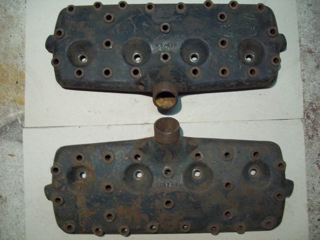

    That is backed up by the same heads in this video:
    I never knew the Bren got a pretty much stock 239 flathead, that's awesome!
    ~Peter
