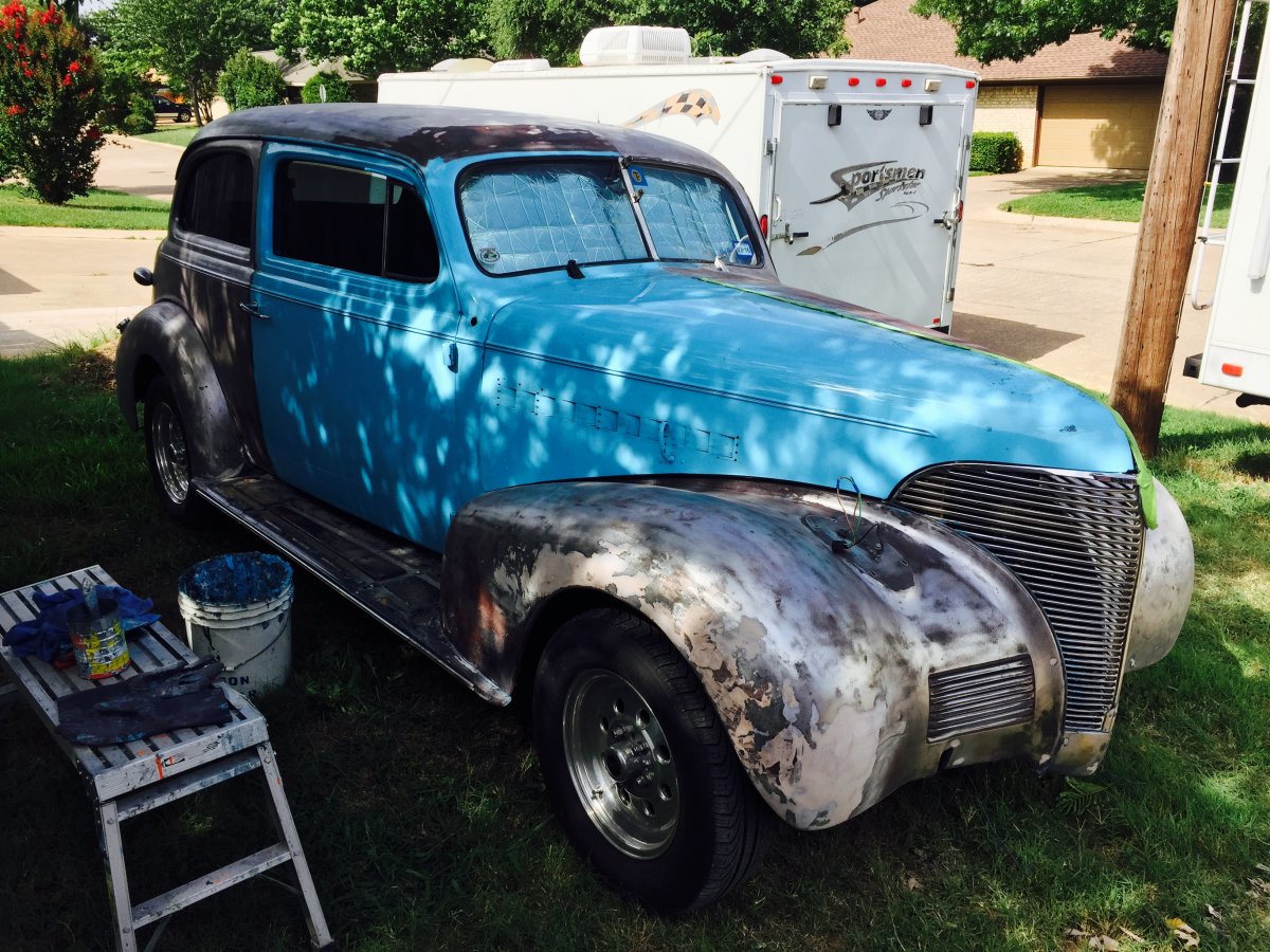

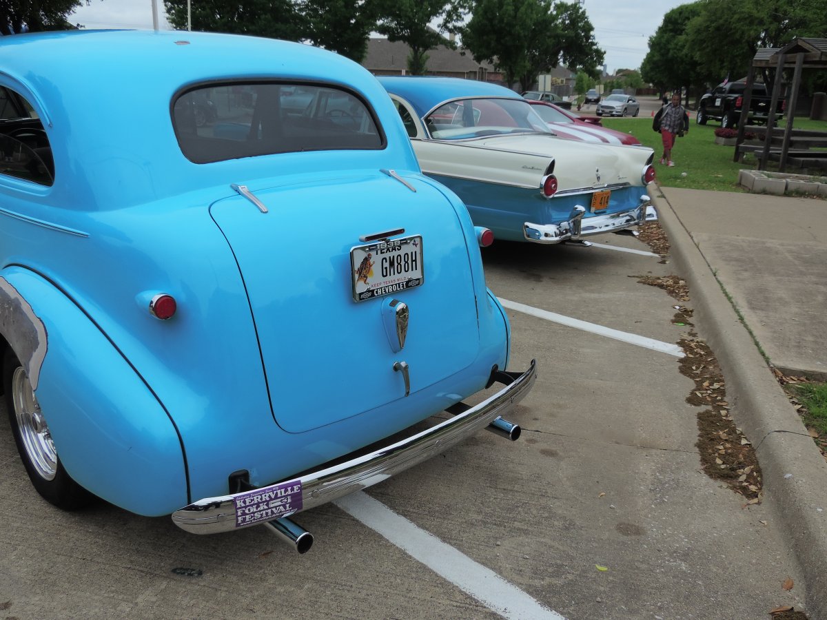

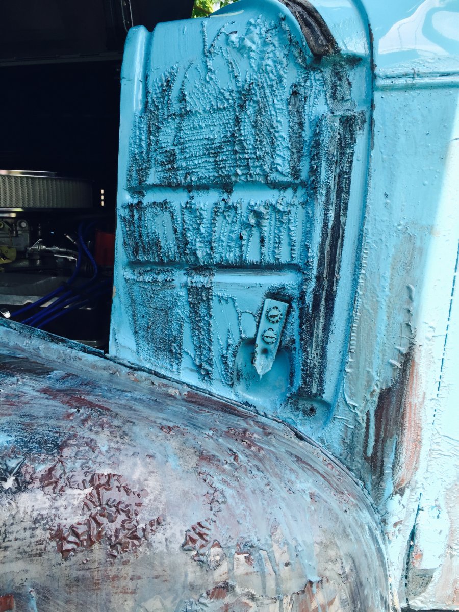

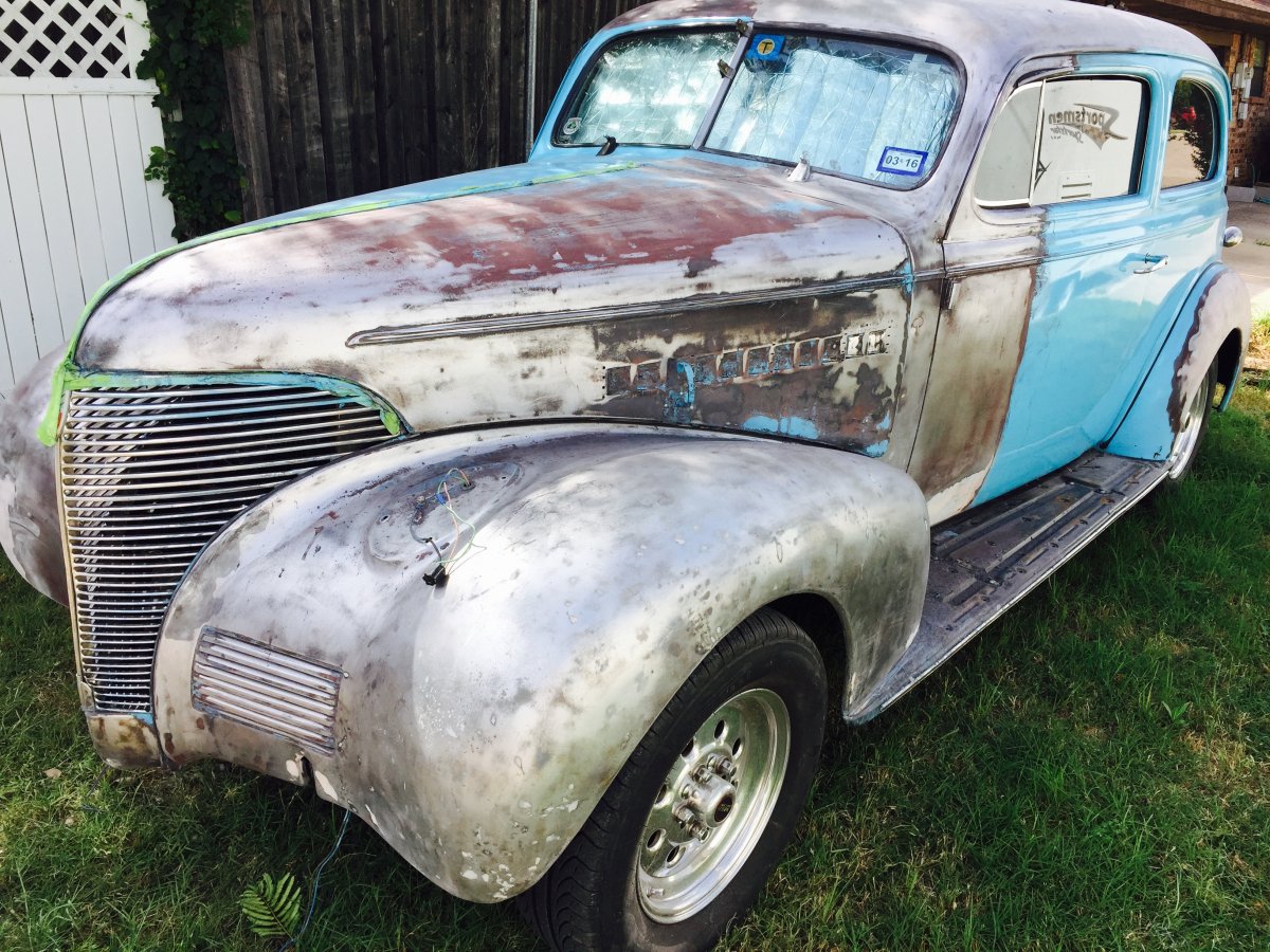

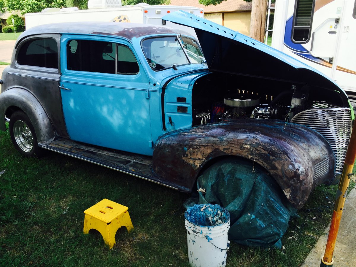

  1. I bought my 39 Chevy a couple of years ago at a swap meet. The guy that built it had passed and apparently it sat quite a while. His wife sold it to a car guy friend and I bought it from him. It needed to be brought back out and driven. He did a pretty good job on the build with a 79 Camero front clip and the usual SBC V8. I've really enjoyed driving it, nearly daily, my family and grand kids love it and I enjoy do the typical mechanic work, manifold oil leak, breaks, master cylinder, starter and the like. Took it to a few car shows and it looks good and compares well with similar cars, but its not really a custom or a hot rod. Someone call it a Resto Mod. I think that sounds like something a doctor would do to your colon. I kissed the fender back in the spring and started to repair it. My grand daughter informed me that her elementary school was having a car show & carnival fund raiser and she told her 1st grade teacher her "Papa" had a great old car and I would be there! SO, I was there. 2015-4-13a.JPG 2015-4-13b.JPG That's when I decided that the car needed more than just a fender repair. It was time to take it back down to the metal and do at least a little custom work to improve and personalize the car and take it up to the next level. I've never done this type of body work, but after reading custom build threads for a couple of years I decided no guts no glory and I got out the big sander! I found a ton of body filler all over the car. The previous body guy had the car real smooth but it looked kind of thick or plastic. I also started uncovering some rust and metal issues here and there. Over the 4th of July weekend I rolled it out in the yard and got out the paint stripper.

    Biggest challenge so far is welding the sheet metal. The new replacement piece welds fine but a lot of the original metal tends to burn through. I'm using a copper shoe and find that if I clamp it in place it pull out more heat and frees up my other hand to improve my gun control. My Northern Tool 135 welder just won't do the thin metal so I borrowed my son's Hobart Handler 125 and it does a pretty decent job. Yes, I know, I ought to get off my wallet and get a TIG. Well gotta go. I'm surly open to suggestions from this community. That's mainly why I started this post.
