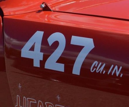

    The biggest advantage to the 427 that I've found, is that the art on the car is accurate. It's a magical number.
