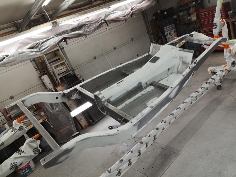

    Yes I'm also 6'2" with a 32 frame, open car under construction.
    We dropped the floor 6" to the bottom of the frame rails like metalshapes did. We built the trans tunnel (to accomodate a T5) and floors and welded it all in.
    Exhaust is ovalized nascar style stuff that runs up tight to the floor and cannot be seen in side profile and the mufflers are under the trunk floor.
    Rear brake line is a braided ss -3 line through the left frame rail, fuel lines are -6 ss braided through the right frame rail.
    That's a 2" x 6" rectangular tube across behind the seats area with a Chris Alston Chassis Works driveshaft hoop.
    You gain a TON of leg room and can lower the seats to below where a normal floor is (top of the frame) and sit lower in the car, and no one will be able to tell it's a dropped floor car when you drive by. Imagine sitting in a conventional Model A and having your heels sitting on a floor that 6 inches lower, your knees no longer foul the steering wheel and you can run a proper 17" wheel.
    Admittedly one problem you may have with this is that the footwells are narrower and three pedals and steering column is a tight fit, but hey, you can't have everything LOL. See pics of Metalshapes three pedal car here:

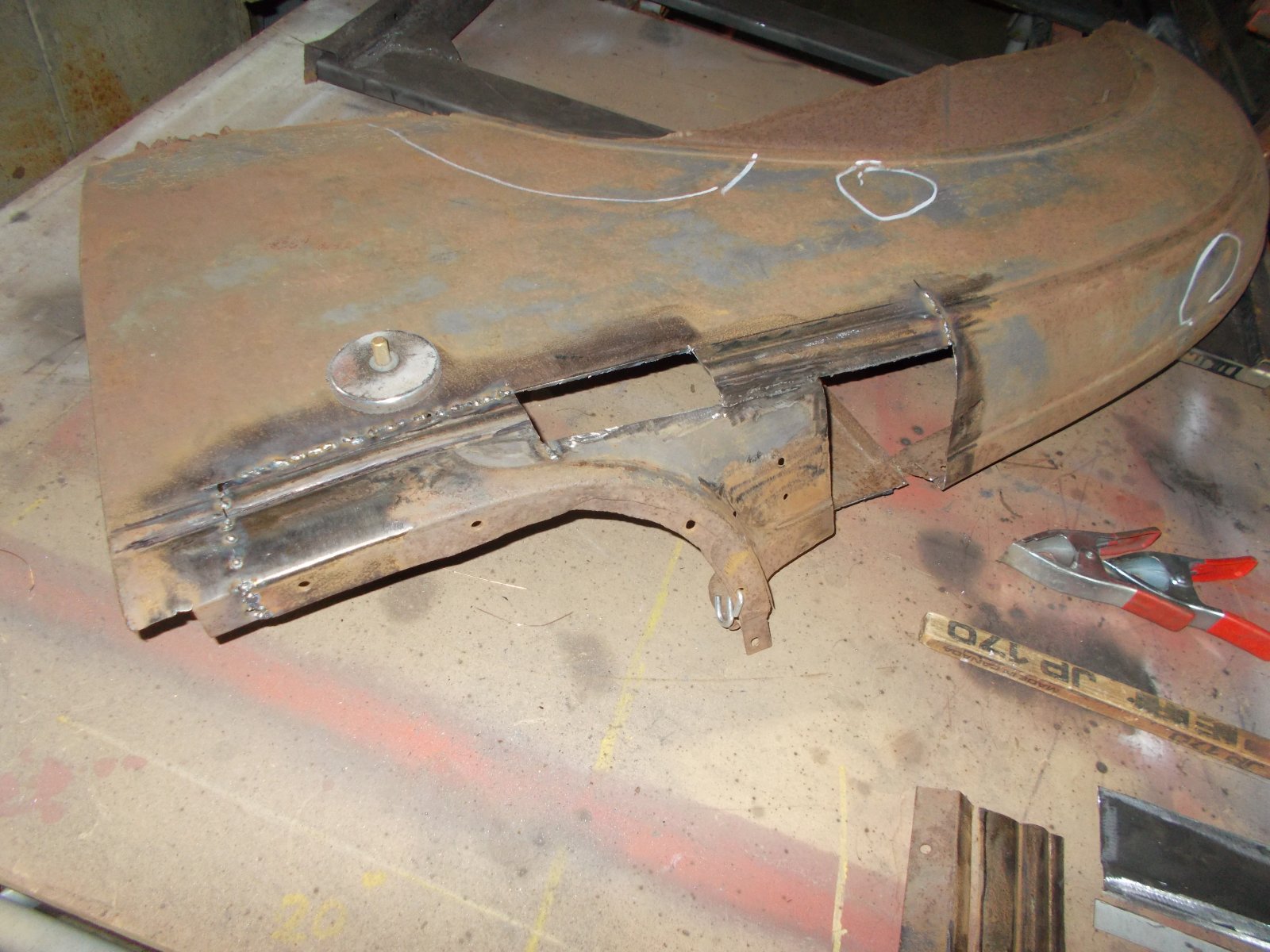

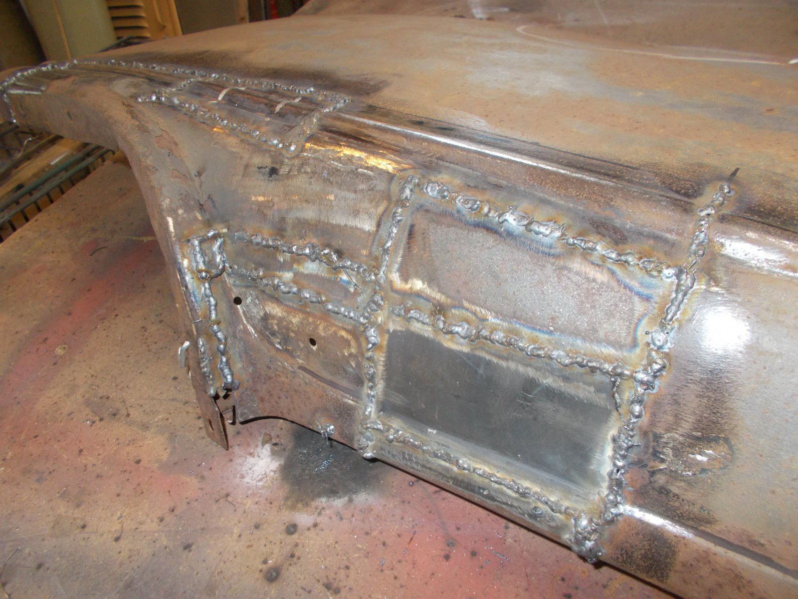

    These are from @metalshapes Build Thread at the link above. Moving the rear section back a couple inches might be your savior coupled with the lower seat...Lots of work but it wouldn't rob the ride of its lines to much in my opinion...if the depth for fit is achieved would the doors have to be lengthened...There is no question every inch added even to the doors would assist entry to anyone climbing in...and Beano's right ass in 1st or be prepared for issues...
    Note Metalshapes Hotrod was a melding of Sport Coupe, Roadster and more see quoted text below...
    "I found a bit more space by using Sportscoupe Quarter Panels ( that gave about 7 or 8" more interior space because the cockpit goes back farther than a Roadster does )
    That meant I had to section them a bit to make them line up with the Roadster Cowl, and I had to make my own doors out of 2Dr Sedan skins & Roadster insides ( lengthened )"

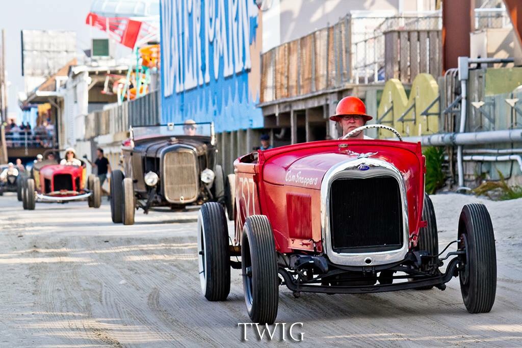

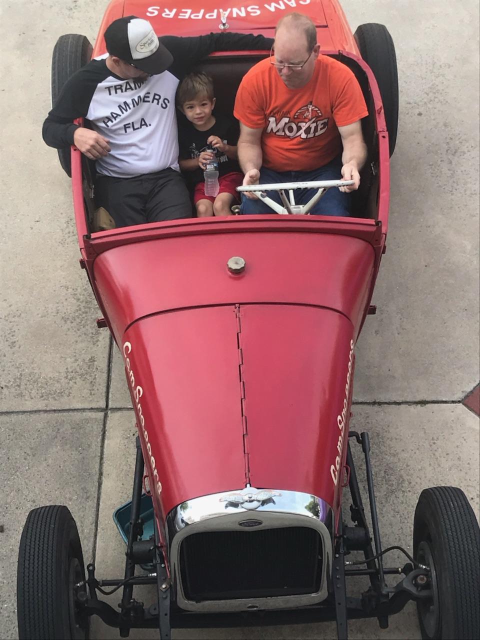

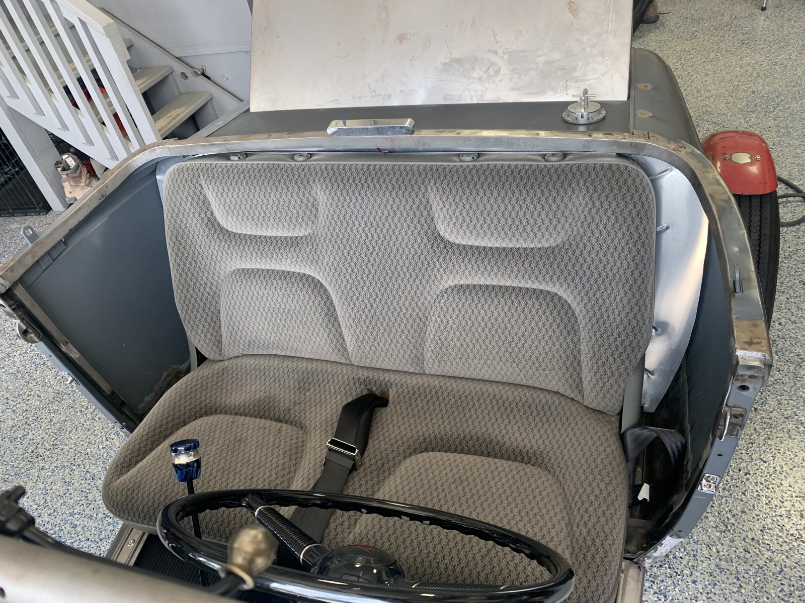

    Also 6'5" I used a second row minivan seat, made short brackets to mount it low and back under tulip panel. 2534.jpeg 2528.jpeg

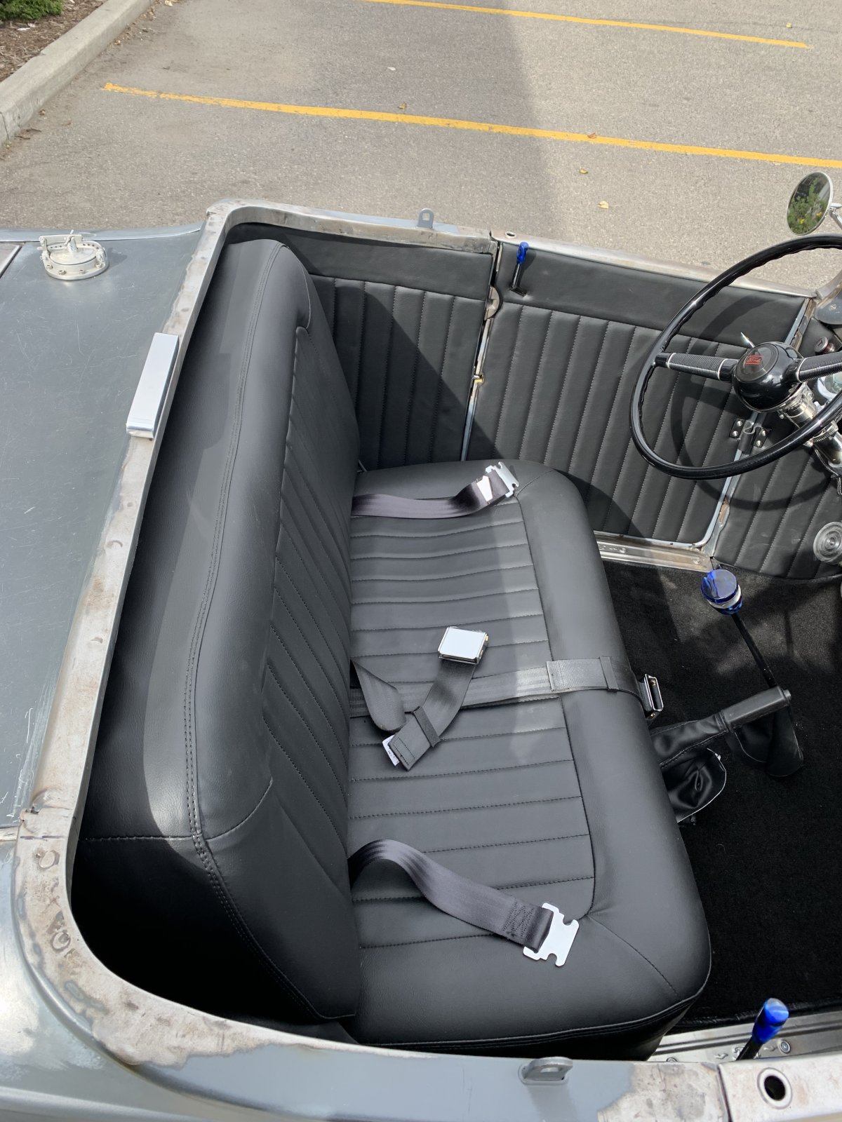

    Just like wheeldog57 I did the minivan seat mounted on custom brackets and tucked it under the panel as war back as I could go. I’m 6’2 and have room to just stretch out my legs

    Great tech Hambers...thats using the real estate for all its worth... I have a gas tank bracing and possibly seat width in my way...These are things that you encounter when it wasn't your build...

    Wheeldog's red roadster is a Cam Snapper, out of Newburyport!
    Saw it on the rear lid.
    wheeldog57 and Stogy like this.

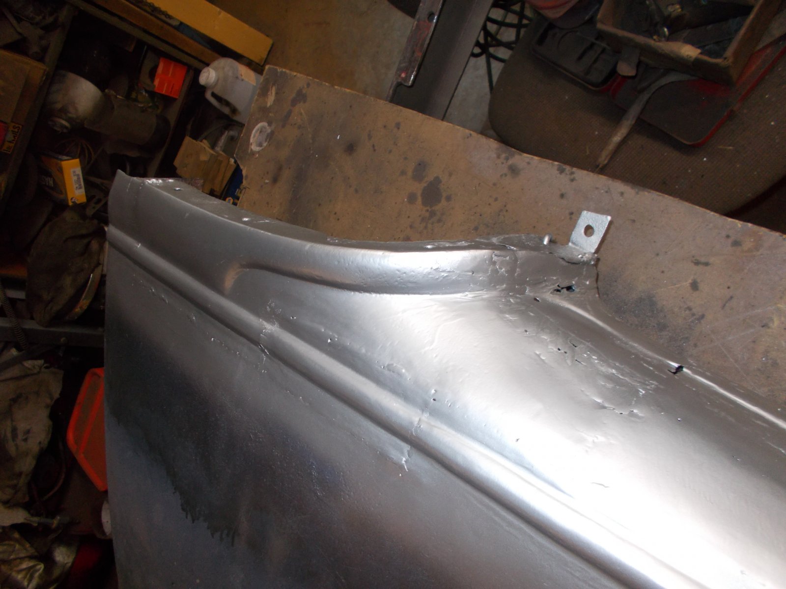

    i shortened my sportie qtrs, but the pix may help you visualize extending yours...
    search 1930 sportster, shortened quarters ... page 4 and up... DSCN3880.JPG DSCN3889.JPG DSCN4874.JPG

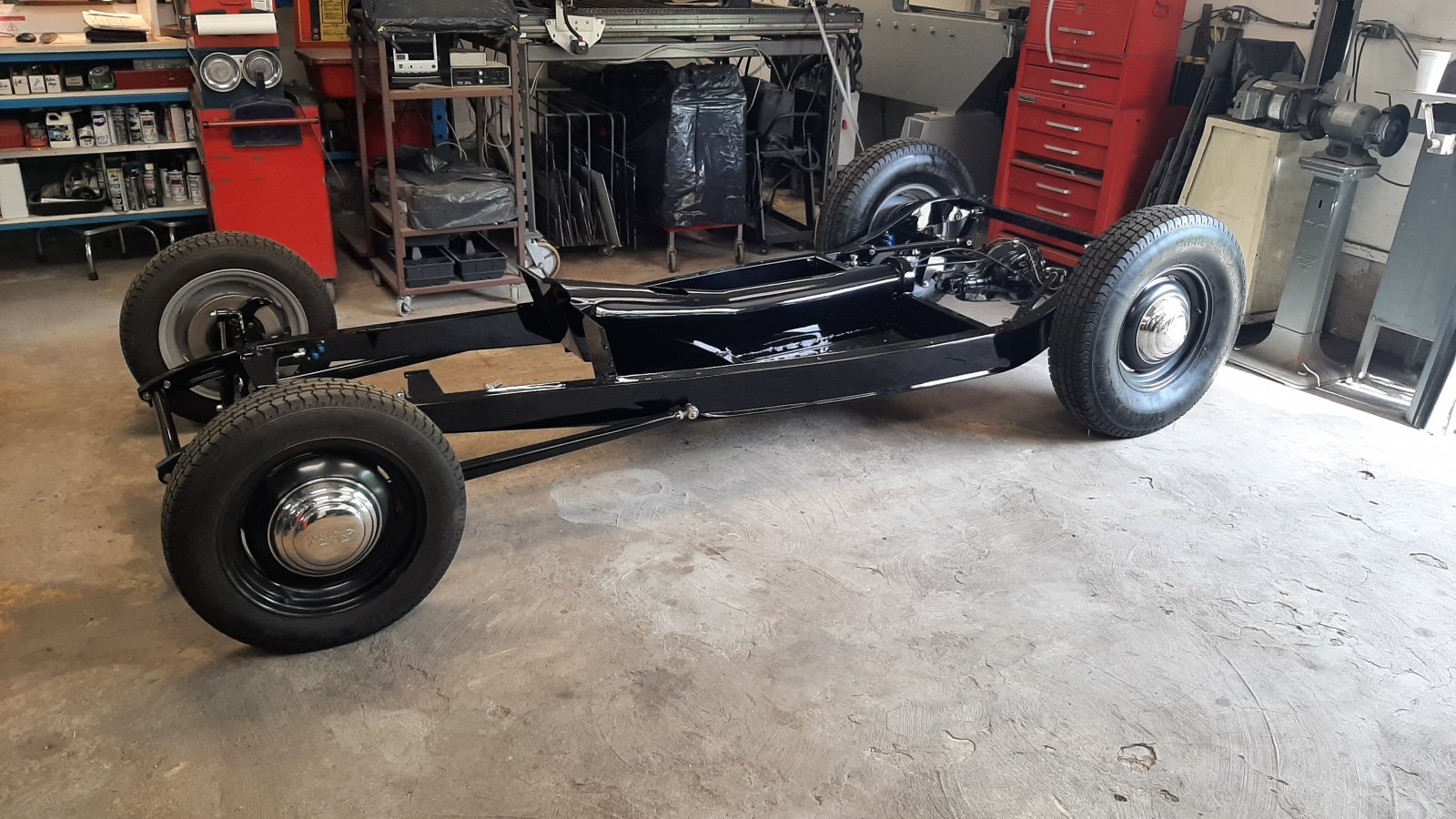

    I should have dropped my steering column down a bit more because the wheel is up close to the windshield. On the other hand, the little extra knee room is needed for my long assed legs. This car was not "engineered" for long rides.

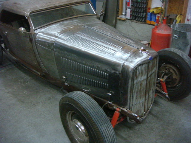

    Thanks for all the nice words about my car, guys.
    I still own it and enjoy it, but it no longer has the supercharged engine.
    It now has a SBC with a simple 4BBL, so I could make a full hood for it with staggered rows of louvers.
