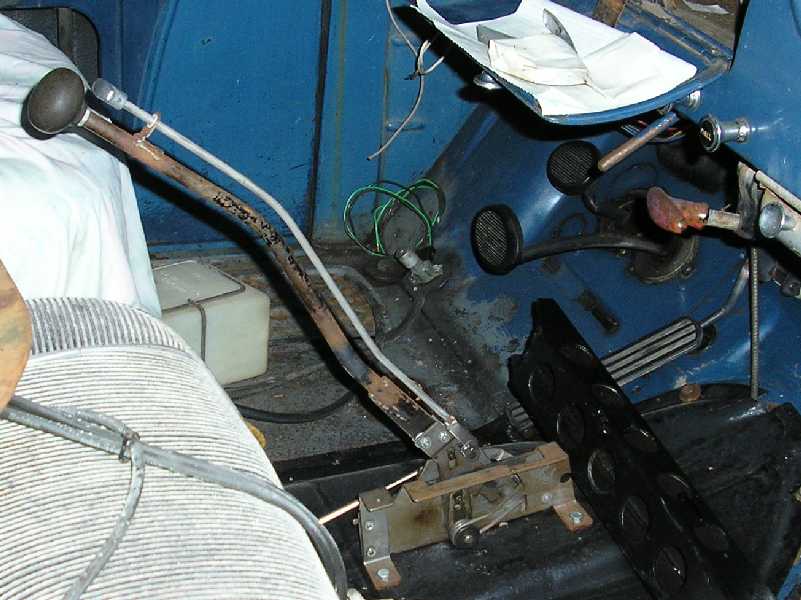

    OUCH! That's why I run with this: [​IMG]
    It ain't old school but it won't break and it won't go in the wrong gear by accident. ever.
