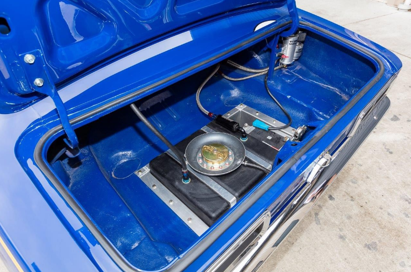

    A common DIY method for an overflow on a fuel cell filler neck is to cut a hole in a common kitchen variety stainless steel bowl for the filler to go through
    Then weld a hose tail to the bowl so a vent hose can connect to it.
    Here's one we did on a Road Race Camaro

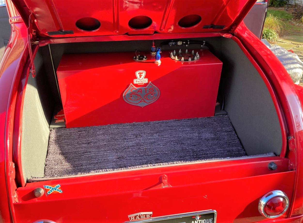

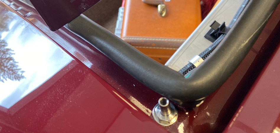

    I found a SS bulkhead air vent and installed it in the gutter outside the weatherstrip on my trunk.
    Tman likes this.

    I'm running a tanks tank in my 30 Model A, it has a roll over valve, vent which I vented thru the floor and an o-ring on the cap. A friend has had one in his 32 for probably 20 years without any problems. Works well for me, I also put a plywood barrier between the tank and p***enger compartment, not as good as a steel panel but gives some protection.
