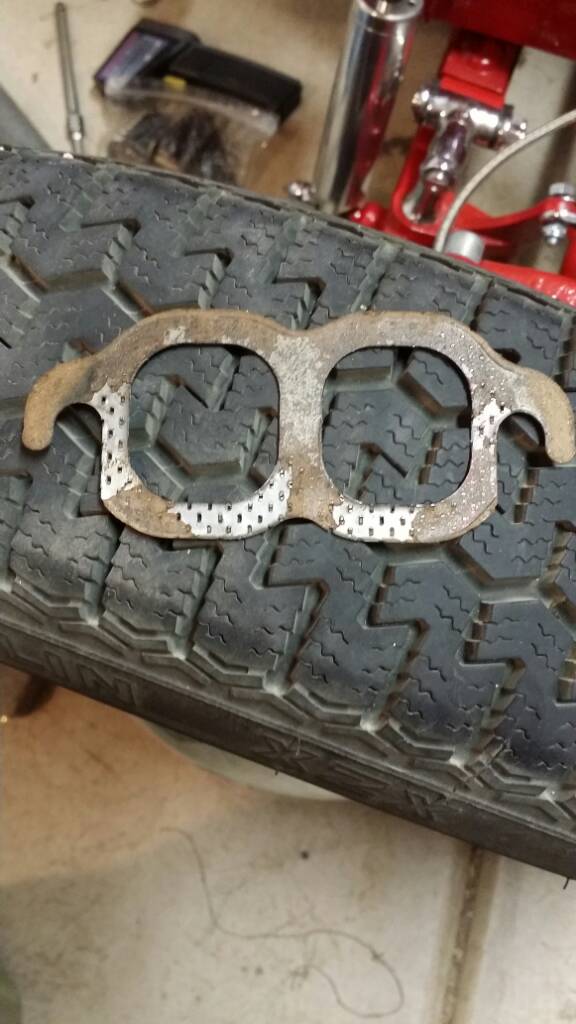

  10. modified
    Joined: Sep 21, 2006
    Posts: 326
    modified
    Backside of old center gasket!
    The paper was stuck to the head, I did not peel it apart!

    I don't think anything is warped, he pulled loose the headers for some fabrication and didn't replace the gaskets.
