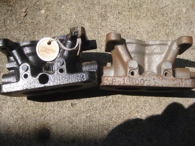

  9. showrod
    Joined: Feb 8, 2007
    Posts: 812
    showrod
    Stromberg made a vacuum base. Although not very common.

  12. seb fontana
    Joined: Sep 1, 2005
    Posts: 9,111
    seb fontana
    from ct
  13. seb fontana
    Joined: Sep 1, 2005
    Posts: 9,111
    seb fontana
    from ct
    Yep..
  14. Torana68
    Joined: Jan 28, 2008
    Posts: 1,443
    Torana68
    from Australia
    who would put that thing on either a car that's the focus of this forum or any high performance engine? I don't know its exact use but looks like a pollution can to reduce NOX emissions by reducing advance? UTTER rubbish :)
