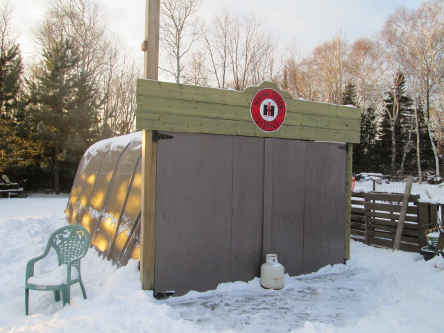

    I put heavy lumber tarp directly on OT car years ago for a winter storage. In the spring I found much paint had blistered due to this and believe it had to do with trapping moisture and frost building at night,melting in the sun,,for 5 months. Now use wigwam.
    You have to put vapour barrier on floor as sun will heat up portable shelter in winter... I learned first cold spell when i checked on truck and there was frost though out cab. I remedied it with StegaWrap on floor..Its a heavy poly, does not puncture easy and keeps moisture..During warmer weather I use it for sandblasting,,,easy recovery of media off plastic sheeting, and a false front with swinging doors to protect shelter from prevailing NW wind IMG_1239.JPG FullSizeRender.jpg
