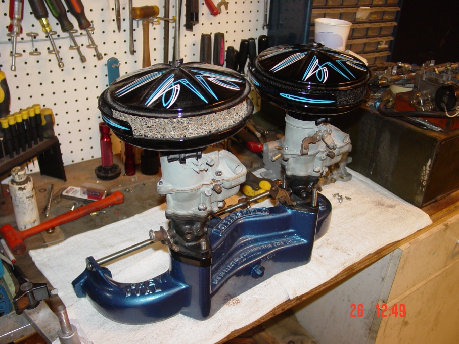

    Here is my contribution to the Tattersfield family. The bottom plate on mine is made to be used with water for heat. It can be done either way. You could get a plate for yours from Langdons and can pipe it for water or exhaust heat. Or if you were really lucky and had the Fenton headers with the stove box already in place, you could just bolt the intake to the exhaust for heat.

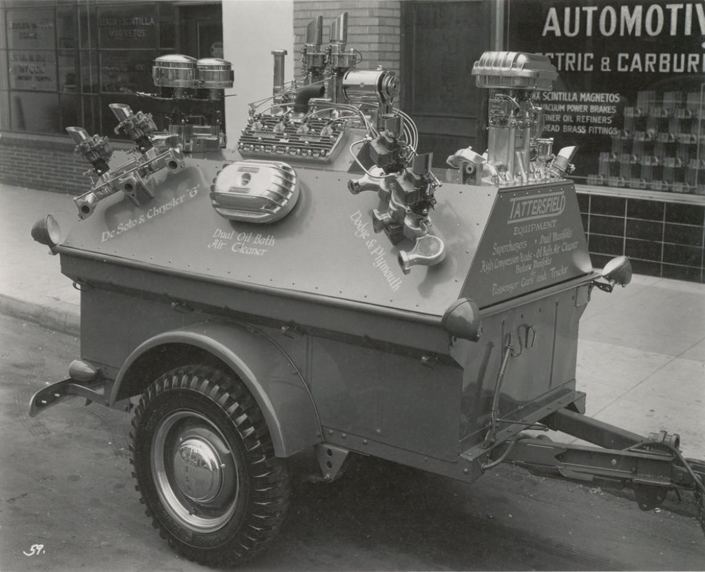

    A hopped up Jeep trailer?

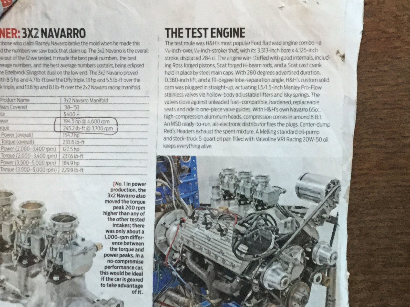

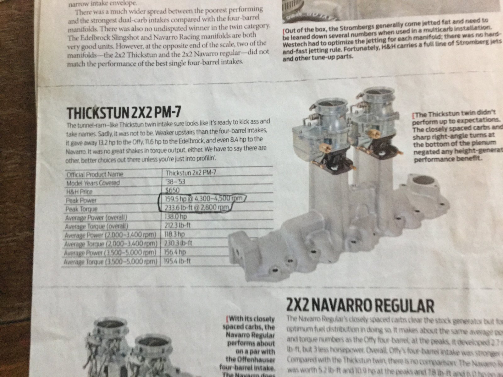

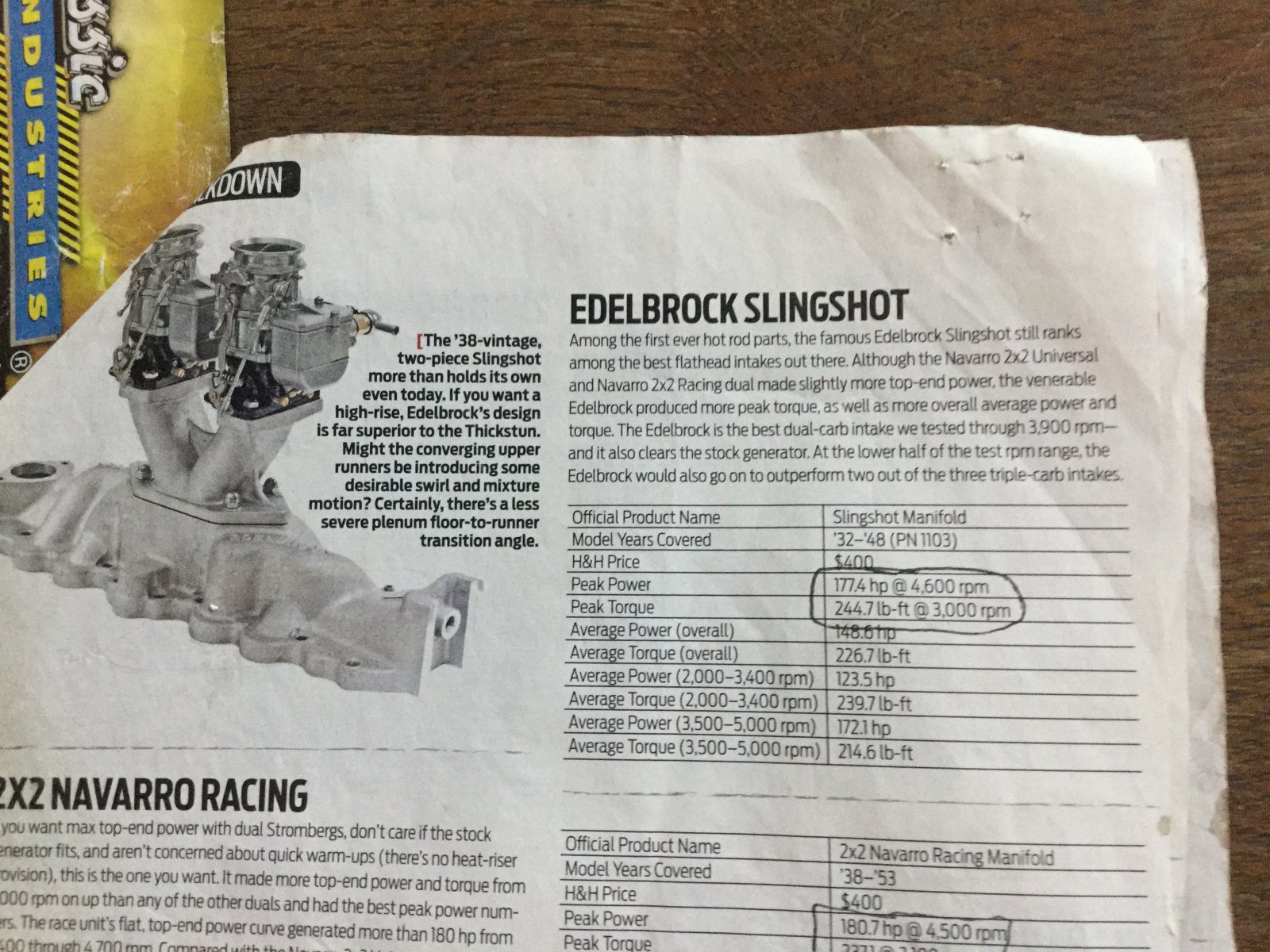

    Hot Rod mag conducted a intake manifold shootout involving the flathead Ford v8—they used a strong bored,stroked,cammed “mule” motor that almost reached 200 hp with a Navarro 3-2 intake. A**** the best performers was a Edelbrock slingshot. Granted this was on a strong engine(results may be different for a stock engine) but there was 18 hp(which is a lot on a Flathead) difference between the slingshot and the tall 2-2 Thickstun with the Thickstun being a****st the POOREST performer. 51C4706A-B277-48C5-B788-216462D4C198.jpeg 61AA14F7-4652-4819-94C4-A130FA92B804.jpeg B92F0848-9AE2-4D6A-BA0C-8B87DBDC9600.jpeg
