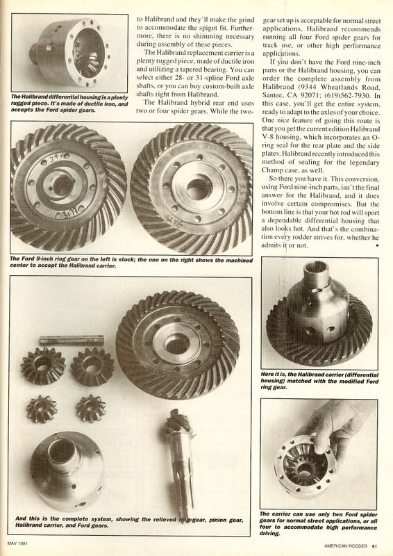

  6. No info here but a cool picture........
