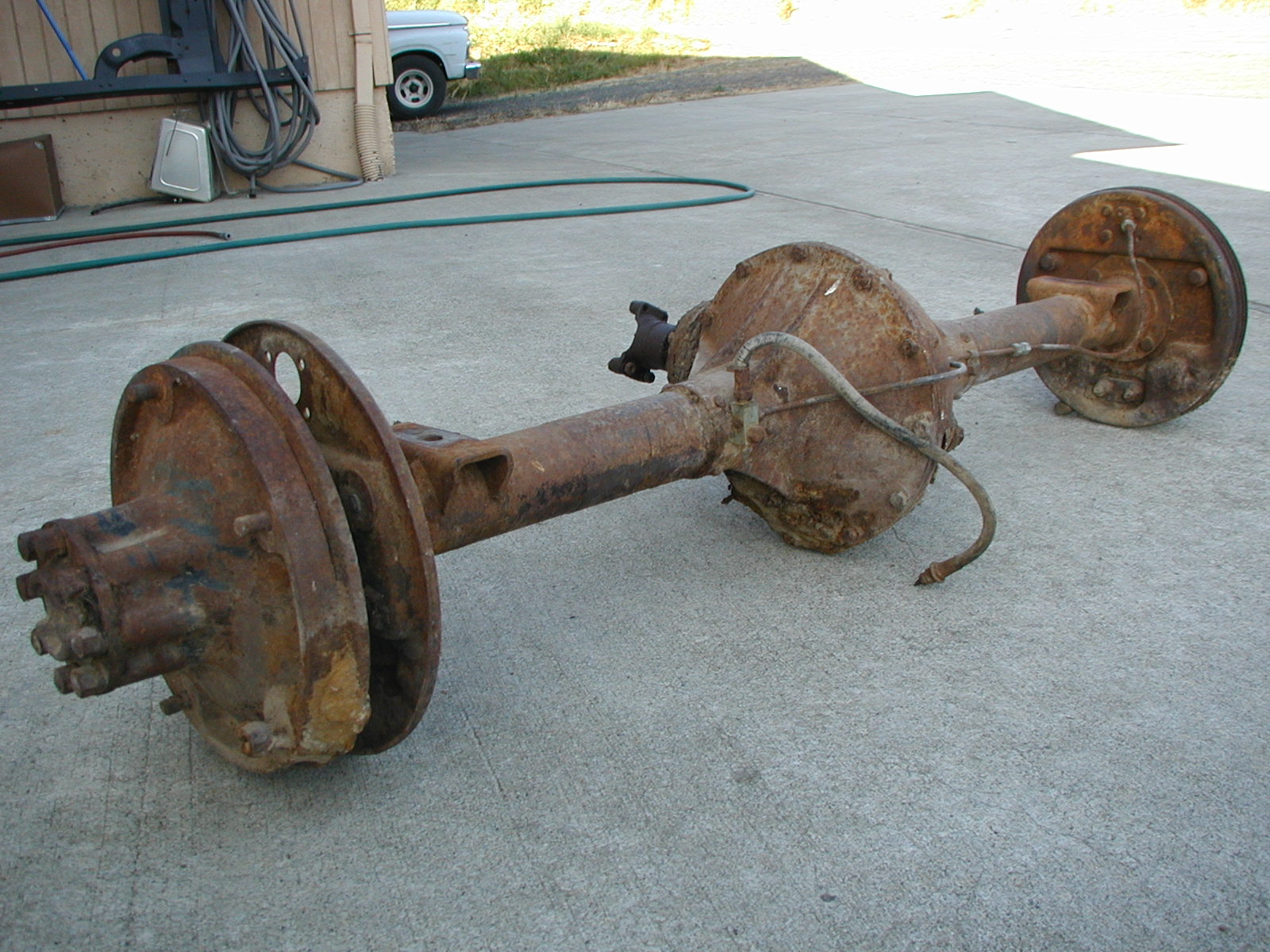

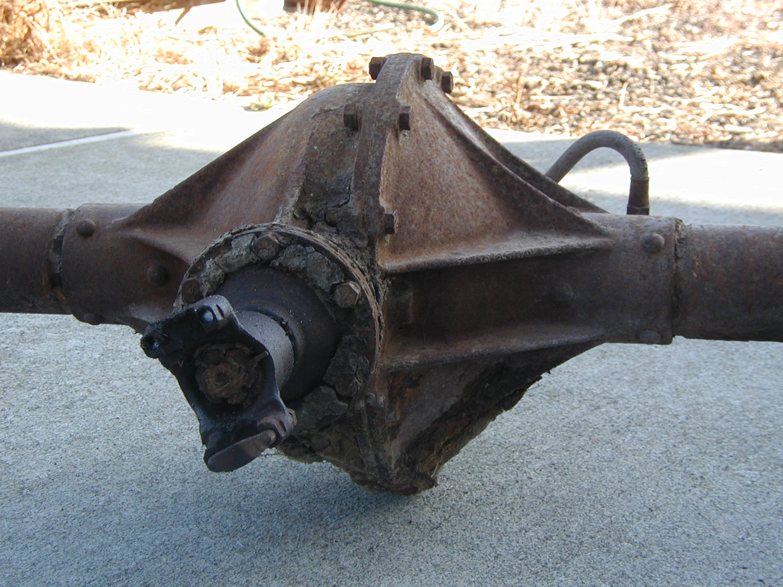

    Great thread, I noticed several mentions of 3/4 ton Ford rears, with one removable housing for use on 11 bolt Champ center sections. For ID purposes this is a stock 39-41 3/4 Ford unit.

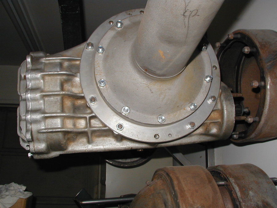

    I've had a 301 from Torrance for a few years, and had been looking for the 3/4 ton truck housings, but had not had much luck... Alas, I came to learn that the Winters bell pattern fits my center section. I picked up the adapters, and the early style housings, and am happy with the fit and finish...

    I have a couple of 301's, this one has the Halibrand adapters. Those Winters side plates and early housings are high quality, great looking pieces, and should work out well.

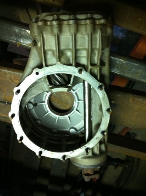

    Halibrand made both aluminum and magnesium 301 cases in Torrance as I have them listed in their catalog. An old mag case should be real dark compared to aluminum. I could tell by looking if you have a photo.

    I did not know that they fit the 11 bolt 301 cases. I have a 12 bolt case which means I still need to find the Halibrand side plates as the truck cases are hard to come by. Here are some copies of the Halibrand adapters made by another mfg I found on ebay. The one set has the ribs you spoke of. (CAE)

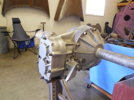

  29. After you posted that and looking at the picture I realized I have an aluminum one. Here is a picture of it just to be sure
