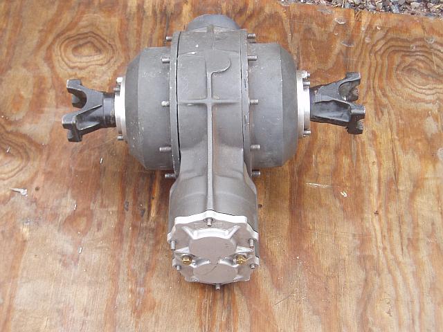

    Thought i'd add this to the pot. I bought this for my 40, I wont be using the IRS side plates, but it's pretty cool. I know absolutely nothing about it,just added for the curiosity value.
    Lots of good info here, gonna help me alot when the time comes, thanks.
