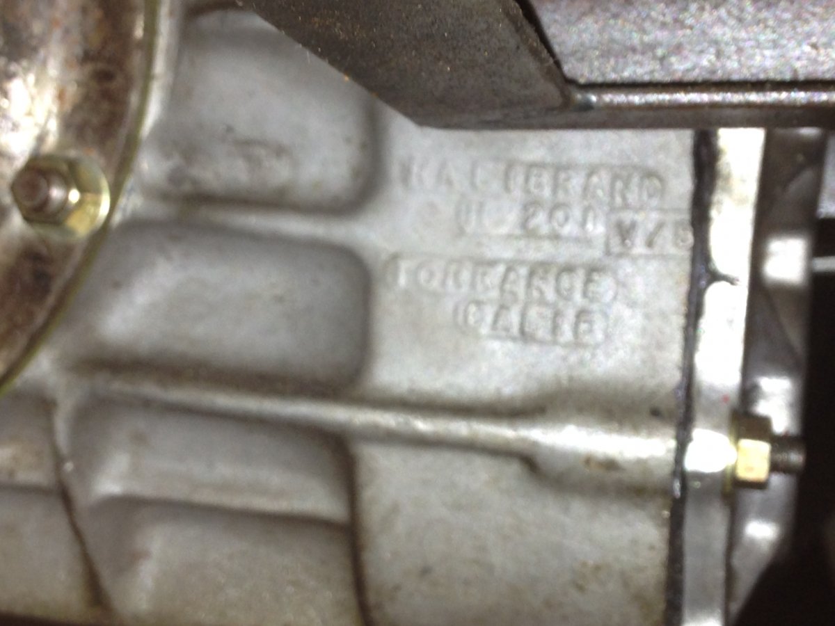

    image.jpeg My v-8 says Torrance Calif. Not sure how old it is.

  10. alchemy
    Joined: Sep 27, 2002
    Posts: 22,824
    alchemy
    I meant on the rear cover.

  11. Pat
    Joined: Jan 6, 2002
    Posts: 199
    Pat
    from Felton Ca.
    Got it. Didn't pay attention to the cover part. I have a repop Culver City cover but my friend has the original cover. I'll check it out.
