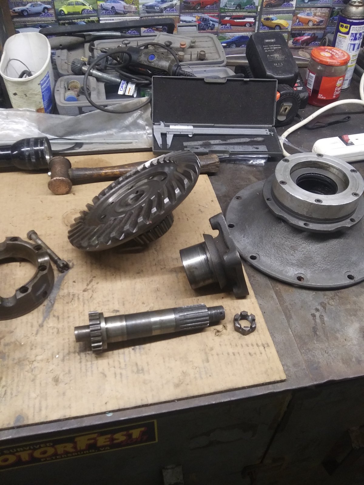

    @Jimmy Campbell
    Can you please post a picture of the guts of your diff laid out in order? I think you are missing the left hand spring that keeps the dog clutch engaged?

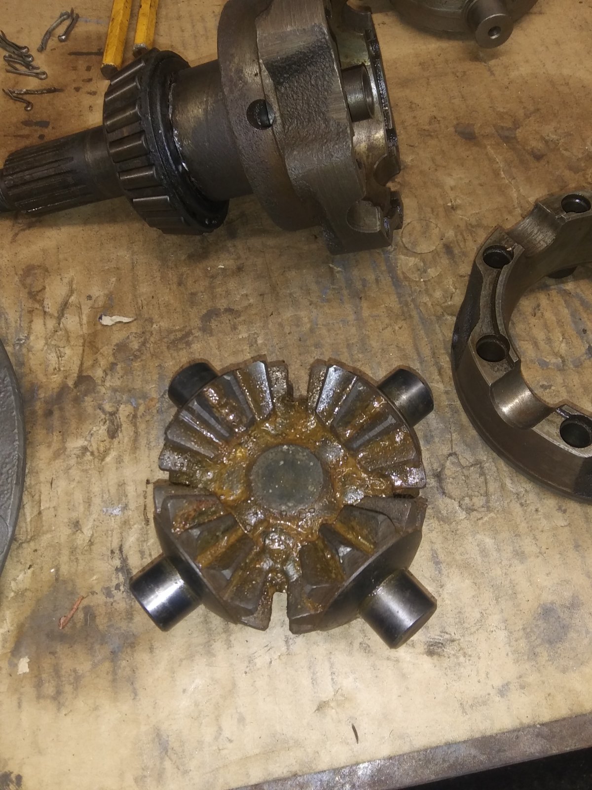

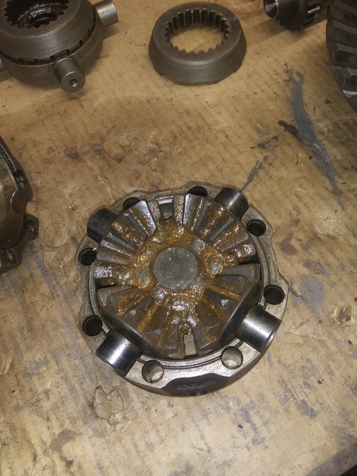

  5. Jimmy Campbell
    Joined: Oct 5, 2021
    Posts: 15
    Jimmy Campbell
    kidcampbell71 likes this.
  6. Jimmy Campbell
    Joined: Oct 5, 2021
    Posts: 15
    Jimmy Campbell
    Correct, no spring on the left side. The spring for the right side is contained in the spider. Not sure how that comes apart. 20211024_182438.jpg 20211024_182505.jpg 20211024_182658.jpg

  7. dumprat
    Joined: Dec 27, 2006
    Posts: 3,572
    dumprat
    from b.c.
    Well that is the problem. Both springs are missing!
    The small spring inside is not for the locker. The locker springs push on the backs of the internally splined dog clutch collars.

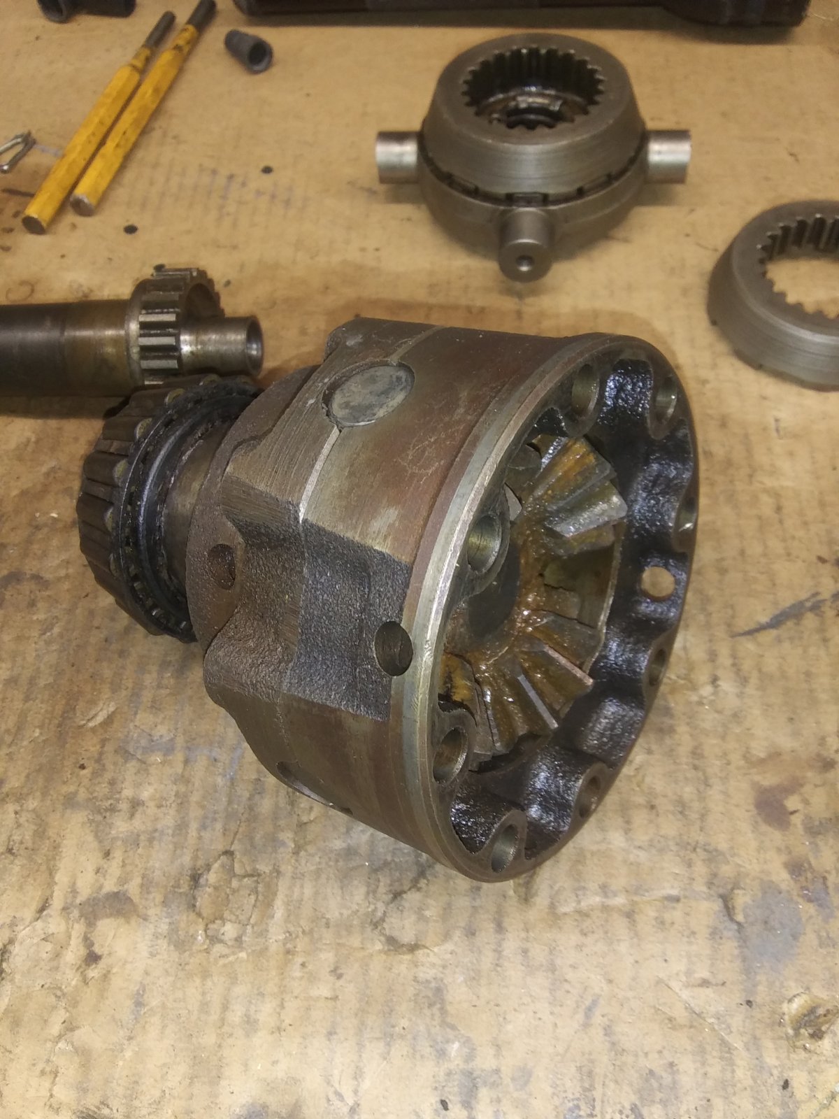

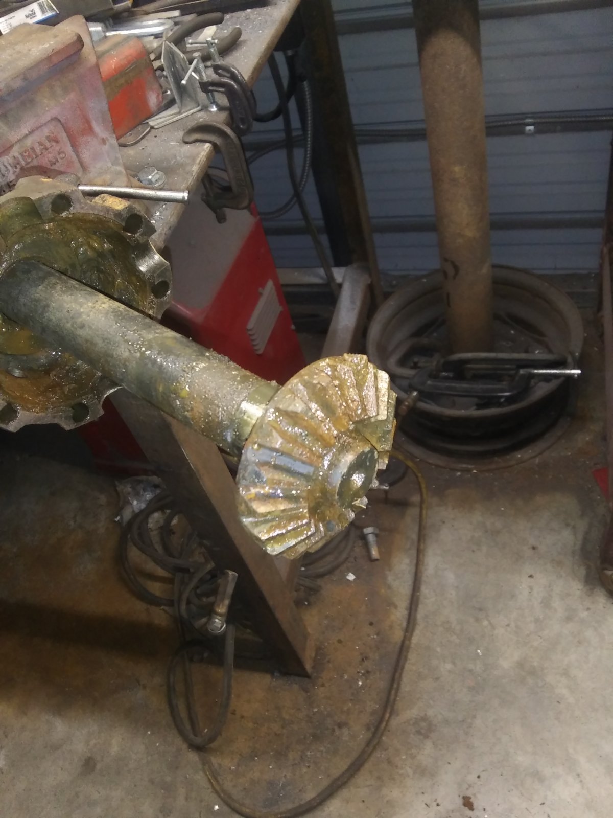

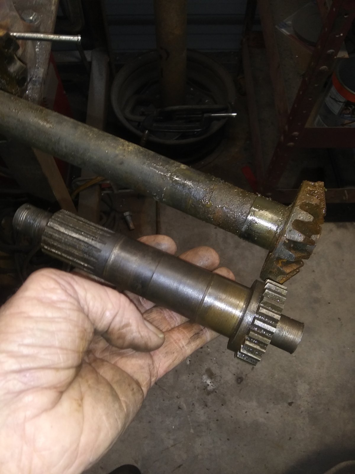

  10. Jimmy Campbell
    Joined: Oct 5, 2021
    Posts: 15
    Jimmy Campbell
    Hey guys, I truly appreciate everyone's input and insite in this matter. Dug a banjo out of the weeds today and this is what I found. After using the hot wrench and hammer I got it apart, as I was told all the parts will fit in my center chunk. How are the gears held to the axle, pressed? No I'm not using these parts but they are all available, right? All I'll need to do is cut, spline and thread the stock axle or modify the stub axles I have.
  11. alchemy
    Joined: Sep 27, 2002
    Posts: 22,824
    alchemy
    Those gears are part of the axle. They don't come off.
    And by "available", you mean NOS, right? I doubt anyone makes new axles and spider gears for banjo axles anymore.
  12. Jimmy Campbell
    Joined: Oct 5, 2021
    Posts: 15
    Jimmy Campbell
    So I'll need to take the stock axles I now have and modify them, no problem, simple machine work. Maybe find some good used parts somewhere.
  13. dumprat
    Posts: 3,572
    dumprat
    from b.c.
    Ok slow down.
    You can completely run what you have .
    I wish I could see and explain this in person.
    The spring in the center of the gears is not part of the locker. It looks like it's to hold the axle shafts apart.
    There needs to be springs on the backs of the dog clutch rings! There is one in the upper left corner of the picture with the banjo center chunk.
    These dog rings drive the car! They need springs behind them to hold them in contact with the teeth on the center pin section of the Detroit.
    Find and off-road shop that build jeep axles. They can probably find you the right springs.

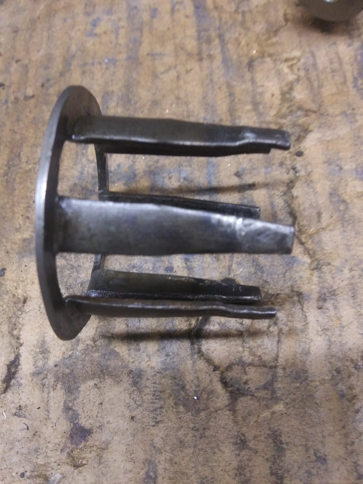

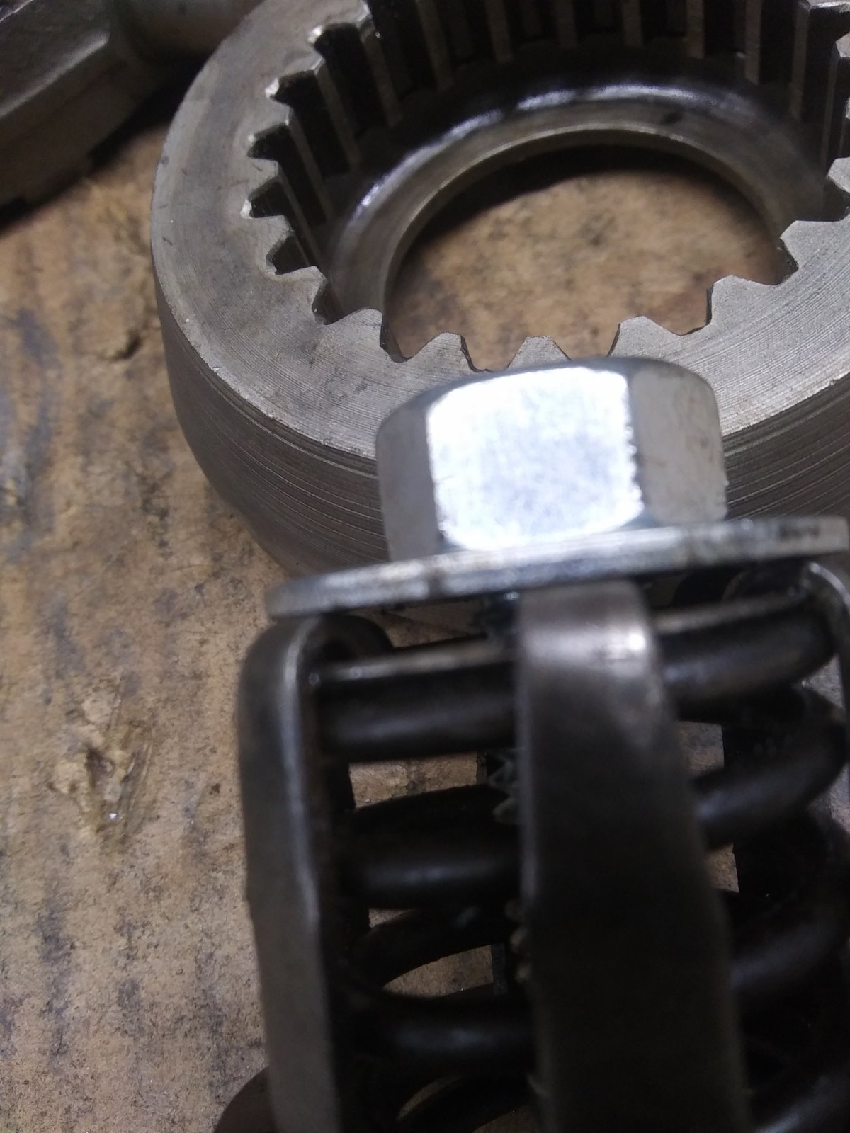

  15. Jimmy Campbell
    Joined: Oct 5, 2021
    Posts: 15
    Jimmy Campbell
    After failed email attempts to dumprat1 and Eaton, I've decided to post more findings here. I know there are many types of lockers but this is new to me. After looking it over again I decided to make a tool to compress the spring inside of the spider. My final thoughts were correct. In the pics you will see two washers with let's call them fingers. The washers hold the dog clutches to the spider by going thru the center and the tips of the fingers bent over to the inside of the spring. The dog clutch that was loose was broke off of the inner part that would have had the place for washer to hold the dog clutch to the spider. Now to use a different email to reach Eaton to see if this is one of theirs. Otherwise, tig it back together and mill it to fit. This unit is appm 50 or 60 years and had a racing career so if there were ever springs pushing on the dogs it would be evident by marks on the dogs and in the housing. All I have is a part number for the dog clutches, 416.

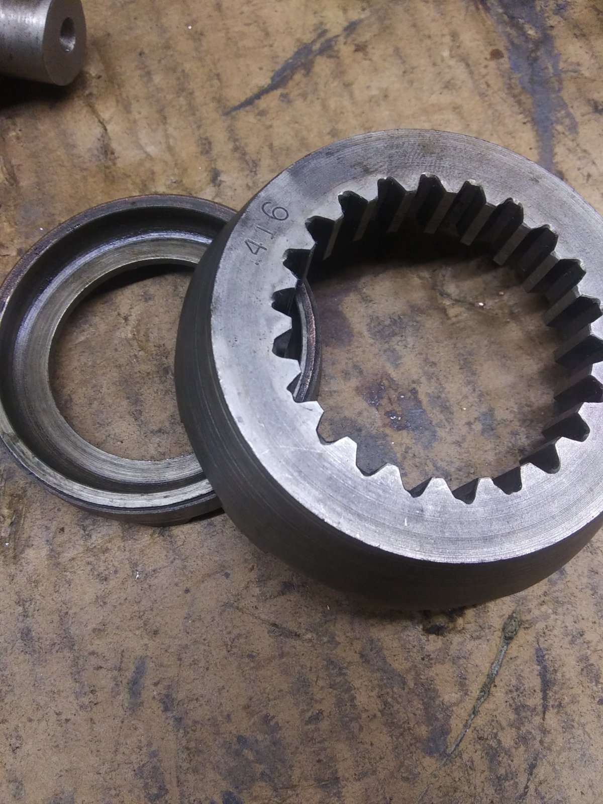

  16. Jimmy Campbell
    Joined: Oct 5, 2021
    Posts: 15
    Jimmy Campbell
    The third pic where the dog clutch is in 2 pieces, not sure but they had to have been more than a press fit. Over Rockwell 60 so if welded it would just crack. Machining marks show indeed they were 2 pieces. EATON said it was one of theirs but out of production. The fellow I need to speak with at Winters won't be back till Mon. So I guess finding original parts is rare? Ray at JobLot in Little Jamaica (Queens) would have them if he was still in business.
