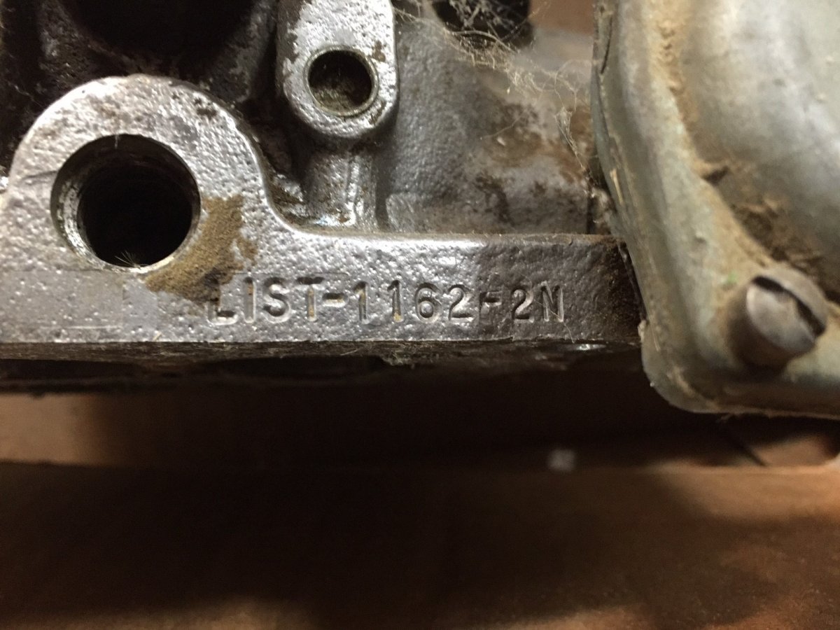

    Does the carb with the "N" have a choke? If not maybe it means No choke.

    Are you sure the "N" is not a poorly or double stamped A?
    An "A" would be perfectly normal.

    Interesting.
    Is the fuel valve a press-in valve or a screw-in valve?
    Jon.

    Jon-
    If I remember correctly, the tapered head br*** plug fitting was typically used with the threaded needle seat and the flat head br*** plug fitting was used with the slip in (held in place by a spring) needle seat. I find the slip in seats with the stainless steal ball end needle to be the most reliable (as in "less likely to leak"! ). :)
