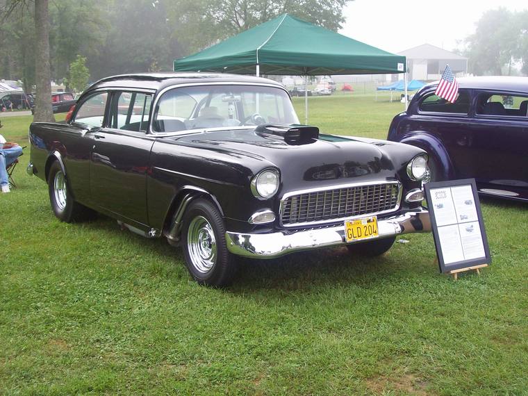

    Here is a pic of the one I did for reference. Not the best picture, but I had to scan it since it was taken before I had a digital camera. By the way, the car had a blown 454 under the teardrop...

    Here is a front shot of it.

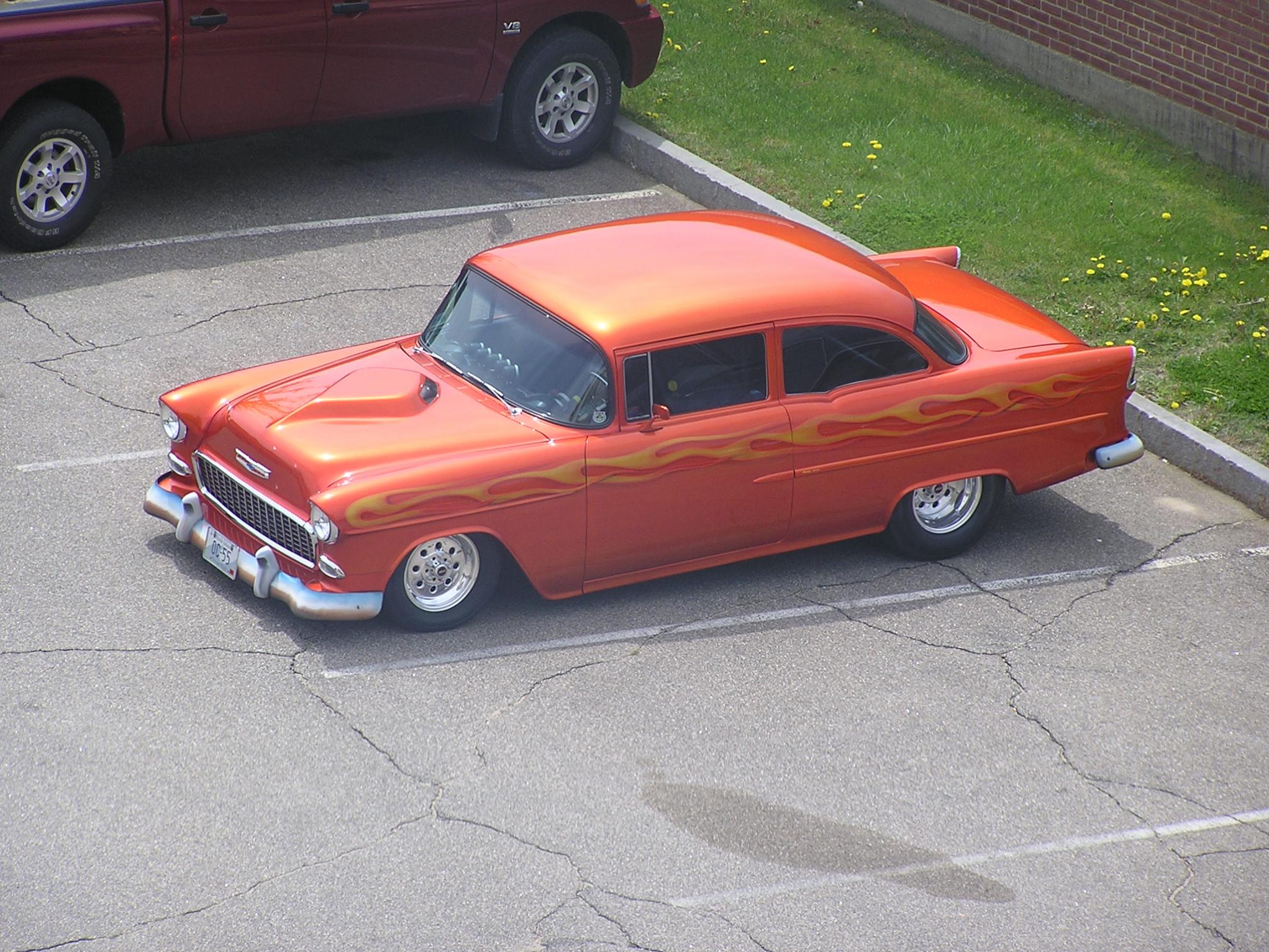

  26. Here is my old 55, with a teardrop. I had that scoop on it for 18yrs. and 2 paint jobs. We used corvette body adhesive to mount it . Never had any cracks. Carlg
