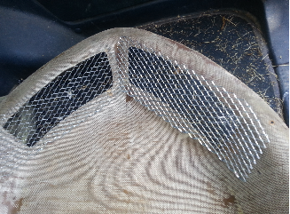

    Larry, we used a combination of things, a bead around the inside perimeter of 3M windshield caulking, pressed the screen into place, and held there with popsickle sticks on the outside in multiple locations, cable ties fed thru the holes to gently pull outward (don't want to bend the screen) and hold the screen into the caulking. Let it set a couple days and applied a nother bead of black seam sealer. Carefully cut the cable ties off, and its been there ever since. Normally I get pictures of everything, but somhow I missed the popsickle sticks. If you have clearance problems, well I did get pictures of that....

    Height mocked up. The aluminum will be used to support the f/g mat while the resin cures. Then it will get flipped over, remove the aluminum, and more mat goes in from the back side.

    It has taken me awhile...MP& C wondering what screen you used? Is there a correct screen type for a tear drop?

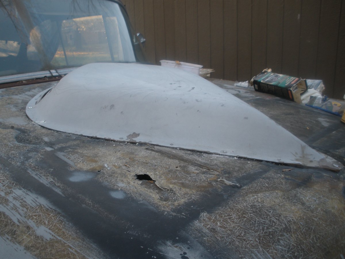

    Finally ready to attach to glass hood. Unless I hear different, I am going to use the 3/16" rivets. How far apart or how many in the scoop? Should I use screws instead? Still looking for the right screen. Screen that is there will be moved. hoodsccoop3.jpg

    Copy of PB292058.JPG It's on! Used a layer of glass/resin mix then riveted with 3/16 and 1/8 aluminum rivets. Thanks so far, now to blend with the hood.

    Old thread, but this works for me and never had a crack - ever.
    photo 4-004.JPG photo 4-003.JPG photo23.JPG photo 3-004.JPG photo 1-005.JPG photo 2-005.JPG photo 1-006.JPG photo 2-004.JPG photo 3-005.JPG

    The correct term for the "Screen" used is called "Wire Cloth"

    Wow....still have not finished this. Cardealer that is another excellent step-by-step.
