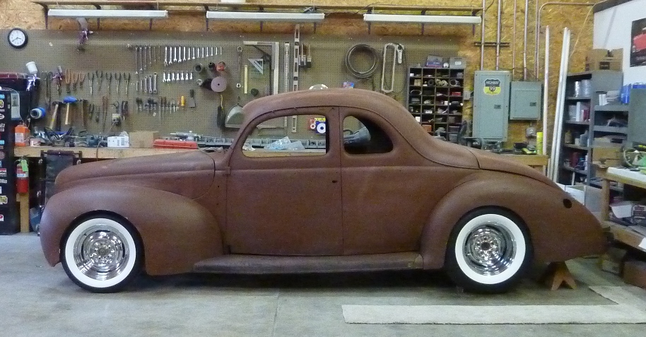

    Fun project at Highway 99 Hot Rods

    Looks like it's been sectioned? Pretty neat looking car!

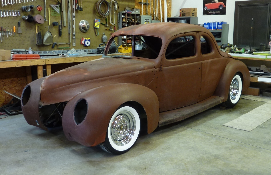

    The body is channeled 2.5", the quarters and hood are sectioned, the fenders are moved up 2.5" on the body (still in stock relationship to the frame) and radiused and the front wheels and arches are moved forward 2". We're just getting started.

    Damn..looks nice. Slant the b pillar and that thing would look like it's going 100 sitting still.

    are you gona chop it too?

    Sort of.
    Imagine a chopped 46 Ford convertible top.

    2.5" channel.
    fenders stock to frame.
    It's still got running boards?
    Either you extended the fenders so the running boards would be 2.5" lower or you cut 2.5" off the bottom of the doors and 1/4 panel.
    Which is it?
    Just curious...

    Still has running boards which are still in the stock relationship to the frame as are the fenders and bumpers. We cut 2.5" off the bottom of the doors and quarter panels
