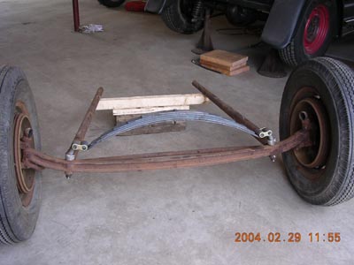

  1. Last saturday I needed to get my front axle ready for the rails that a friend is fabbing up for my 34 pu. This is how it started as a nice complete 36 front axle with mechanical brakes that was holding up yard art in front of the shop...
  2. I stripped the backing plates/brakes, brake rods, spring, etc off of the axle. Everything came apart without incident almost as though I was tearing a '96 ford axle apart.
  3. If you'll notice in the last photo that the R side perch pin has popped up, I had an afternoon appointment with a local backyard machine shop to press the pins out but when I set the axle down on the shop floor I noticed one had popped up voluntarily. At this point my father decided that he'd get involved, we covered the other perch pin with a piece of alulminum and tapped on it with a hammer to see if it would let go. Sure enough with a little persuation it to popped out. I was AMAZED at how easily this thing came apart and happy that I would not have to spend $30 having them pressed out...

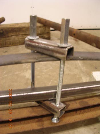

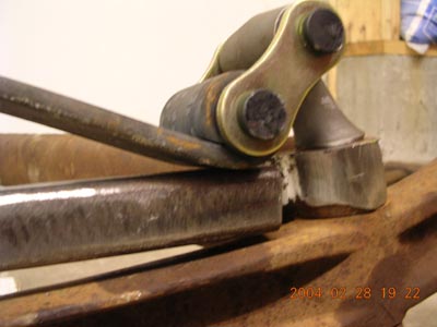

  5. After using a cut off wheel on the grinder to cut the extra meat off the front of the bones where the old spring perches used to live I then ground them round and I was ready to start putting it all back together. I had previously bought new spring perches, shackles and a reversed eye spring. I inseted the perches, installed the bushings and shackles and found out quickly that I would have to build a device to compress the spring and stretch it out to meet the shackle studs. I rummaged around in the backyard and found some tube then threw together this compressor...
  6. This piece of tube ran between the spring eyes acting as a spine for the compressing device to draw the main leaf of the spring downward...

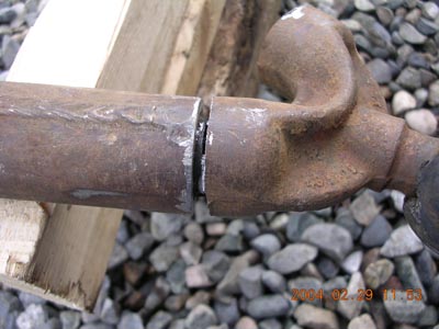

  7. After the main leaf was installed I replaced the rest of the springs and turned my attention to the ends of the wishbone... I used the sawzall to cut around the factory weld that holds the yolk into the bones. Once the welds where gone the old cast yolk slipped out using heavy pliers to wiggle it...

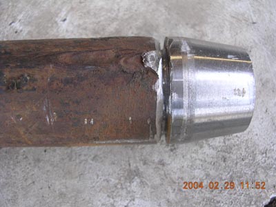

  8. I trimmed the rod ends back about 1/2in until the id was 1 1/8 and used a hammer to tap these 3/4 in speedway bungs into the ends of the now split bones. I decided to hold off welding anything until I was content with a mock up of the chassis...
