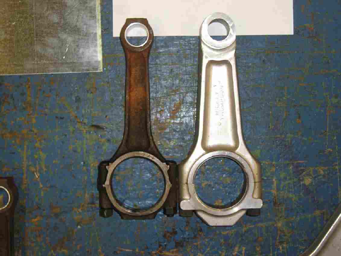

    Now comes the tricky part. 440 rods are exactly .200" shorter than a stock 392 rod. You can see the difference here.

    More importantly, 440 rods are approximatly .020" wider on the big end. Here you can see the gap above the aluminum rod.

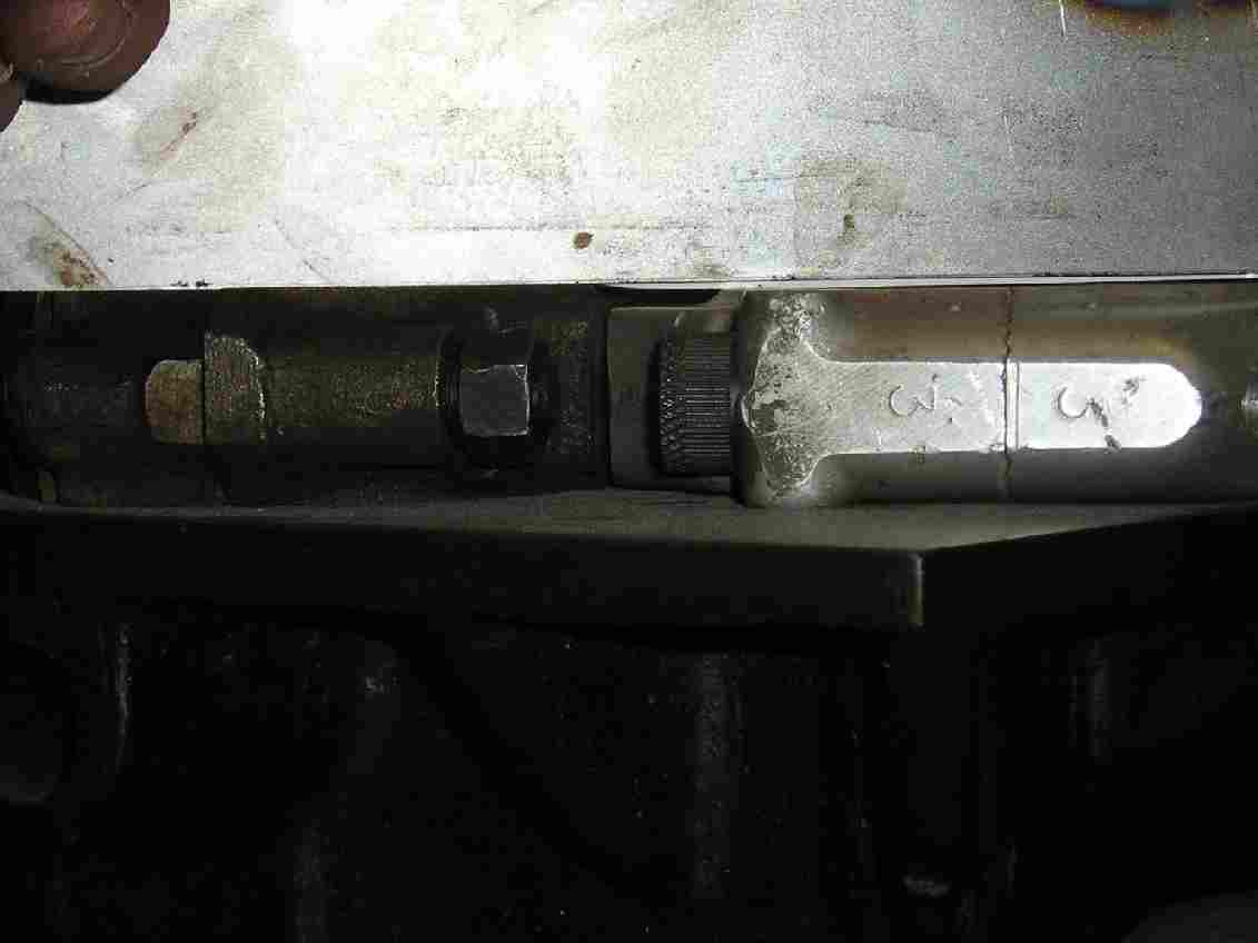

    Using a vernier height gauge, you can see the difference better, and get a very accurate measurment. My rods were .028" wider than the stock 392's. .028" isn't very much, but in an engine, it makes all the difference in the world.

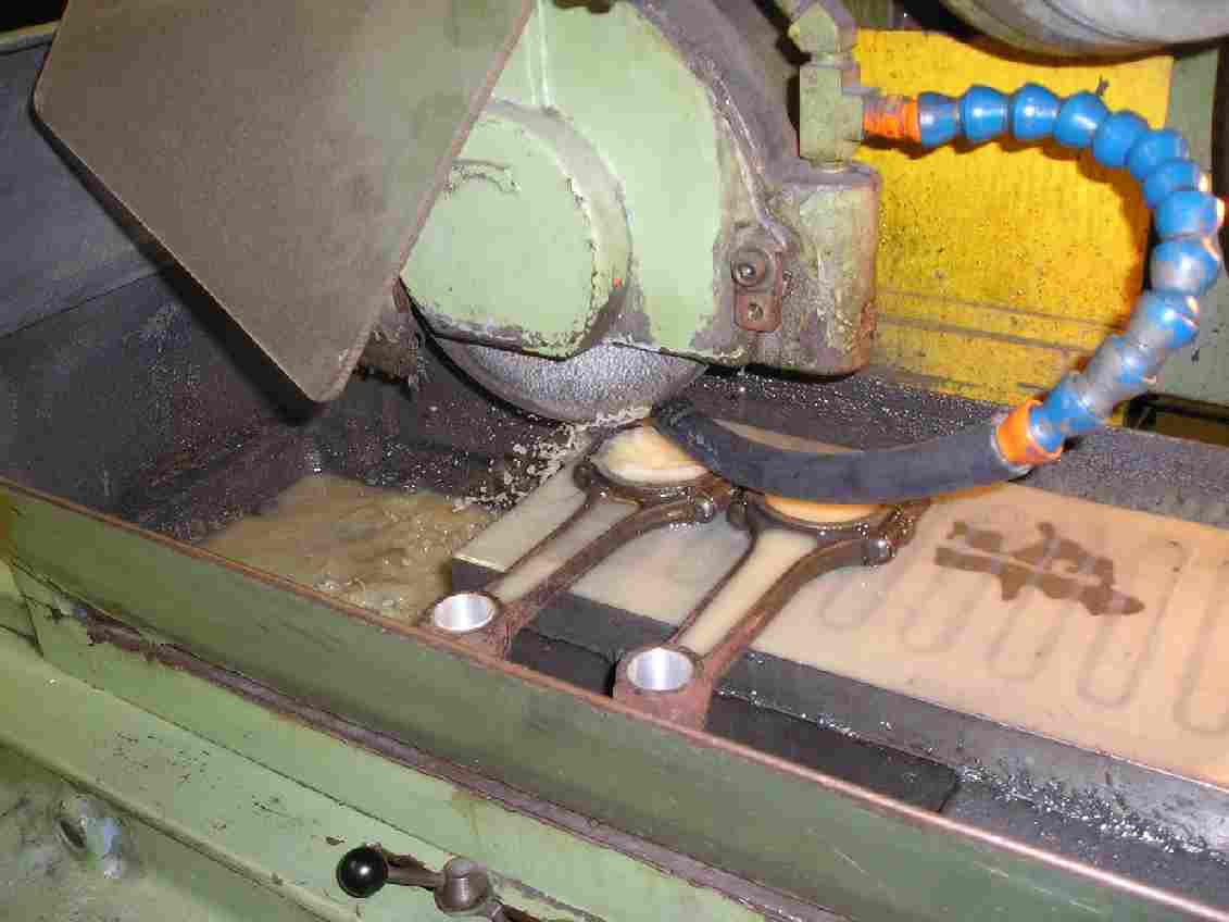

    What's the best way to remove .028 from a connecting rod you ask? With a surface grinder. All good machine shops should have one. I was able to use the one at the school where my Dad used to work. If you're not familier with a surface grinder, it's a very percision grinder that uses a magnetic vise. It is made to grind things perfectally flat. The wheel moves up and down, and the table moves left and right, and in and out. This particulat grinder is accurate down to .0001"(one ten thousandth). Make a pass or too, take the rods off and try them. You DON'T want to take to much off. Grind the same amount off of each side of the rod. You might have to re-chamfer the side of the rod that goes against the crank web.

    Keep trial fitting the rods until you get them to work. The Chrysler spec for rod side clearance is .006 to .014. That gives you a little fudge factor. You also have to narrow the bearings. This is easily acomplished with a dermel, or small file.
    There you have it, 440 rods on a 392 crank. I'll post more when I get to fitting the pistons. You have to make up for the missing .200" on the 440 rods.
