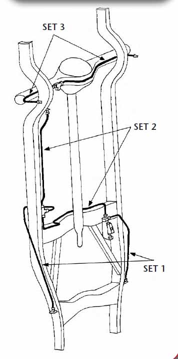

    With this parts list can I just use my existing hard lines?
    Looking at the image of the 1949-50 brake line configuration it would appear that I will wind up with one wheel on circuit one and three wheels on circuit two? Is that OK or would it be better to bend new lines and have one circuit for the rear and one for the front? Are the 1951-54 plumbed different than this diagram?

    53sled
    I ran all new when I did mine. I had the rear line blow before I upgraded, so I figured for another $15 why risk it.

    from California
    when I did mine I used some thick wall tubing with a br*** bushing to slide the pedal arm into rather than use parts of the old master cylinder.
