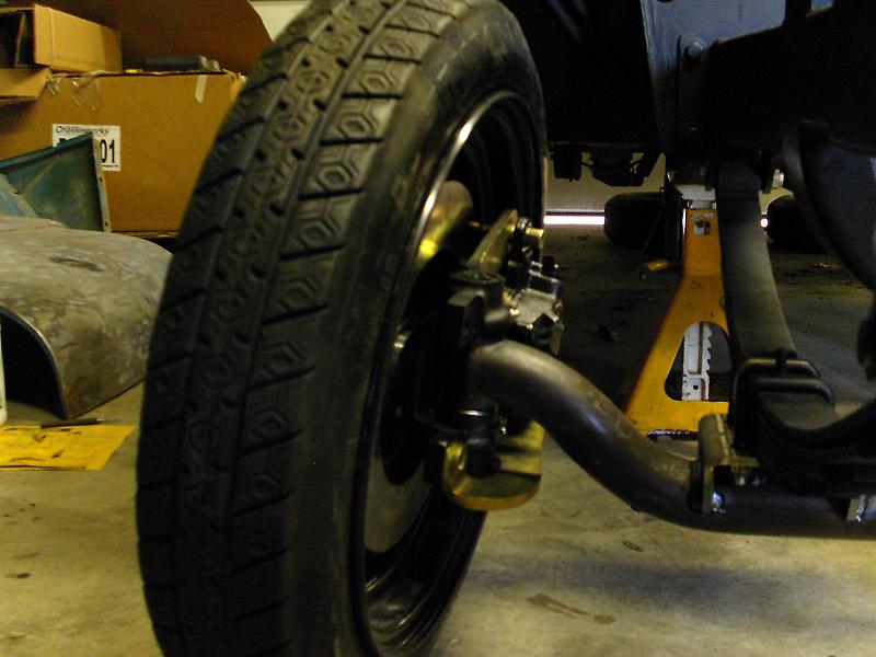

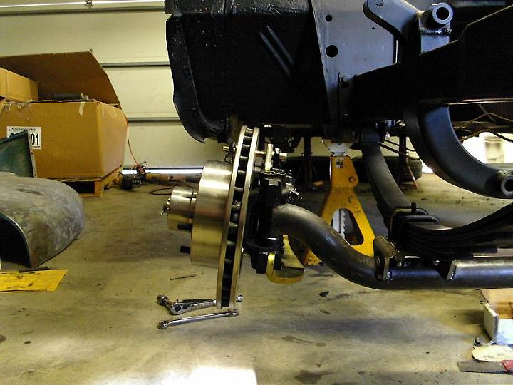

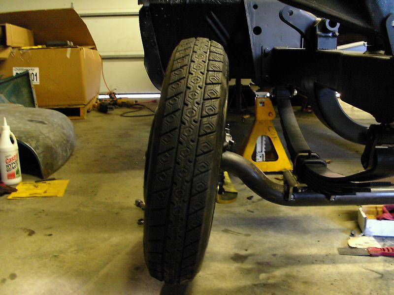

    Here are the pics I just snapped, good side is drivers, bad is passenger...

    Pretty sure the right side spindle is upside down and yes, it makes a big difference which way you put it.

    lol, well I understand it now, just didnt see a difference between the two when a buddy put them on, I was welding up the axle/wheel tubs while he put them on, I asked if there was a difference, he shouted "doesnt look like it":rolleyes:
    Guess Ill flip it tomorrow:eek:
