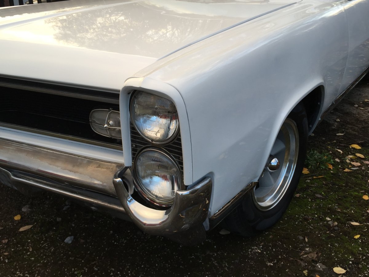

    You can't beat 5 spokes can you. That's a really nice Poncho. Wouldn't mind seeing more of it even if it's bone stock.

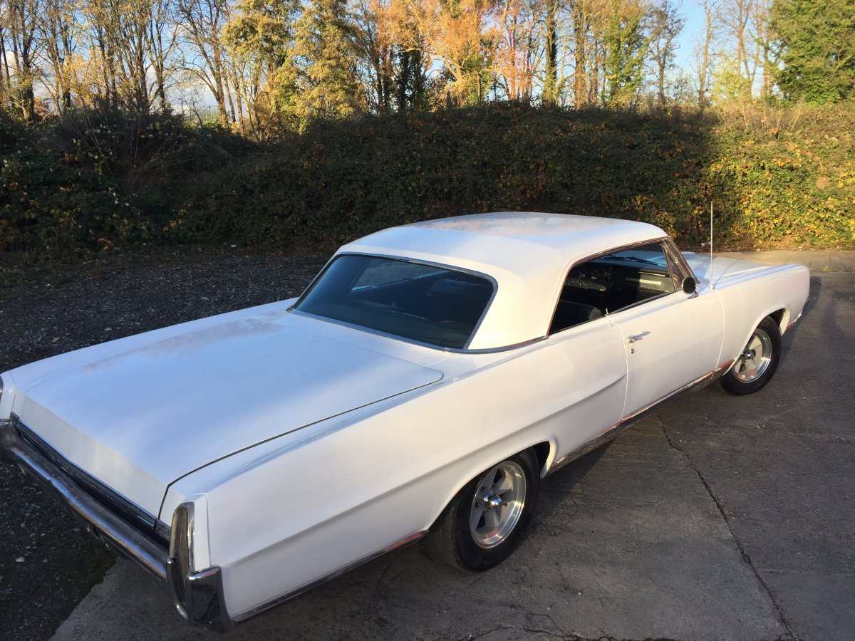

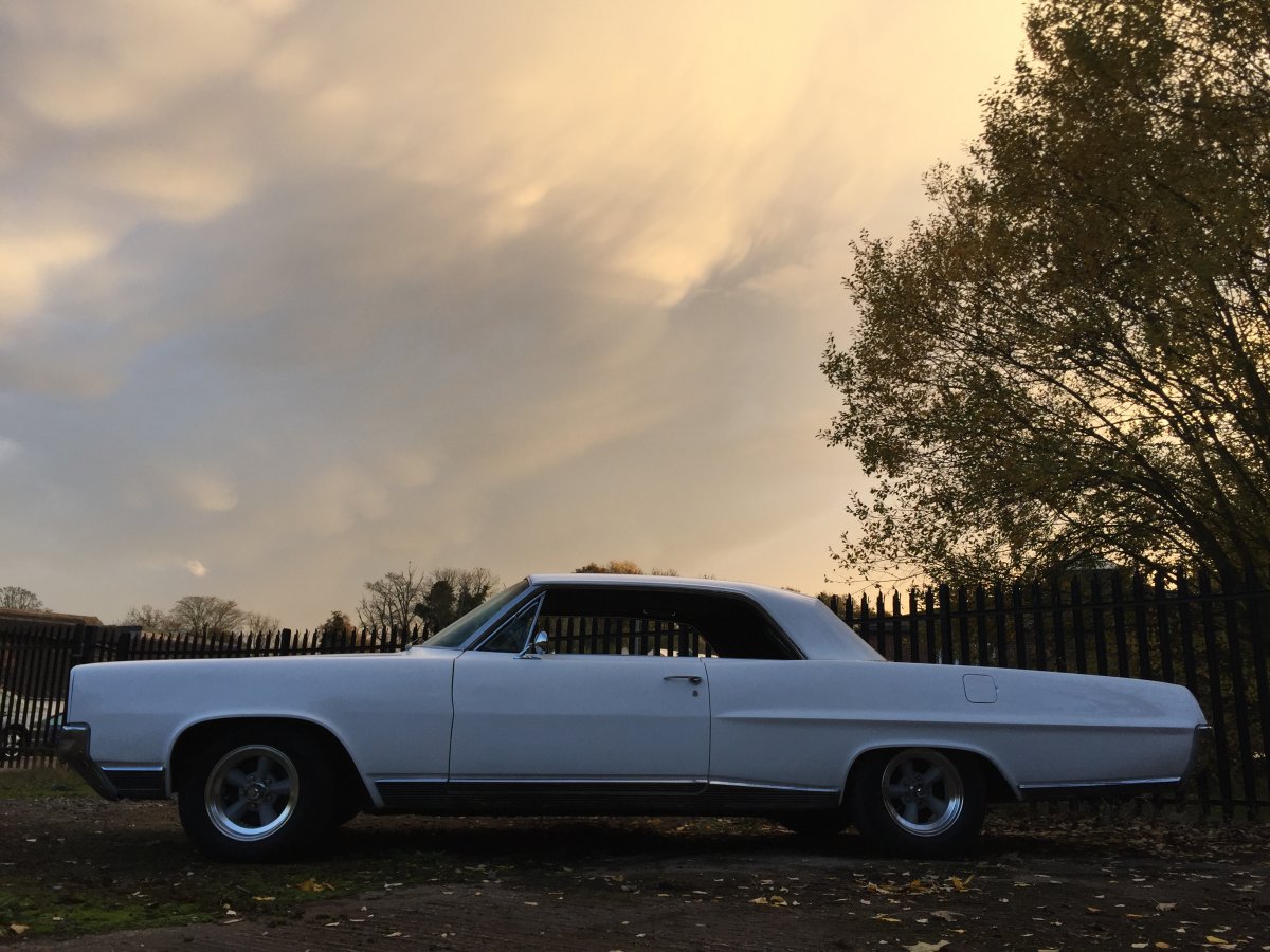

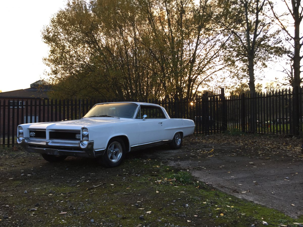

    C4846E21-F779-4EBB-B68D-65FC20C61A3A.jpeg AFA0A36A-D448-46BB-AF84-2B736AD19E15.jpeg AAF09AC9-060A-4ADB-BB6D-E9133564952F.jpeg 706FAB7F-FABC-4A46-ADC5-63DCB1248D0C.jpeg Thanks dude ... love this car !!

    How many bodies can you put in that trunk...that thing is beautiful.

    We reckon on 6 adults if you cut them up
    But that just between you and me! Heheh
