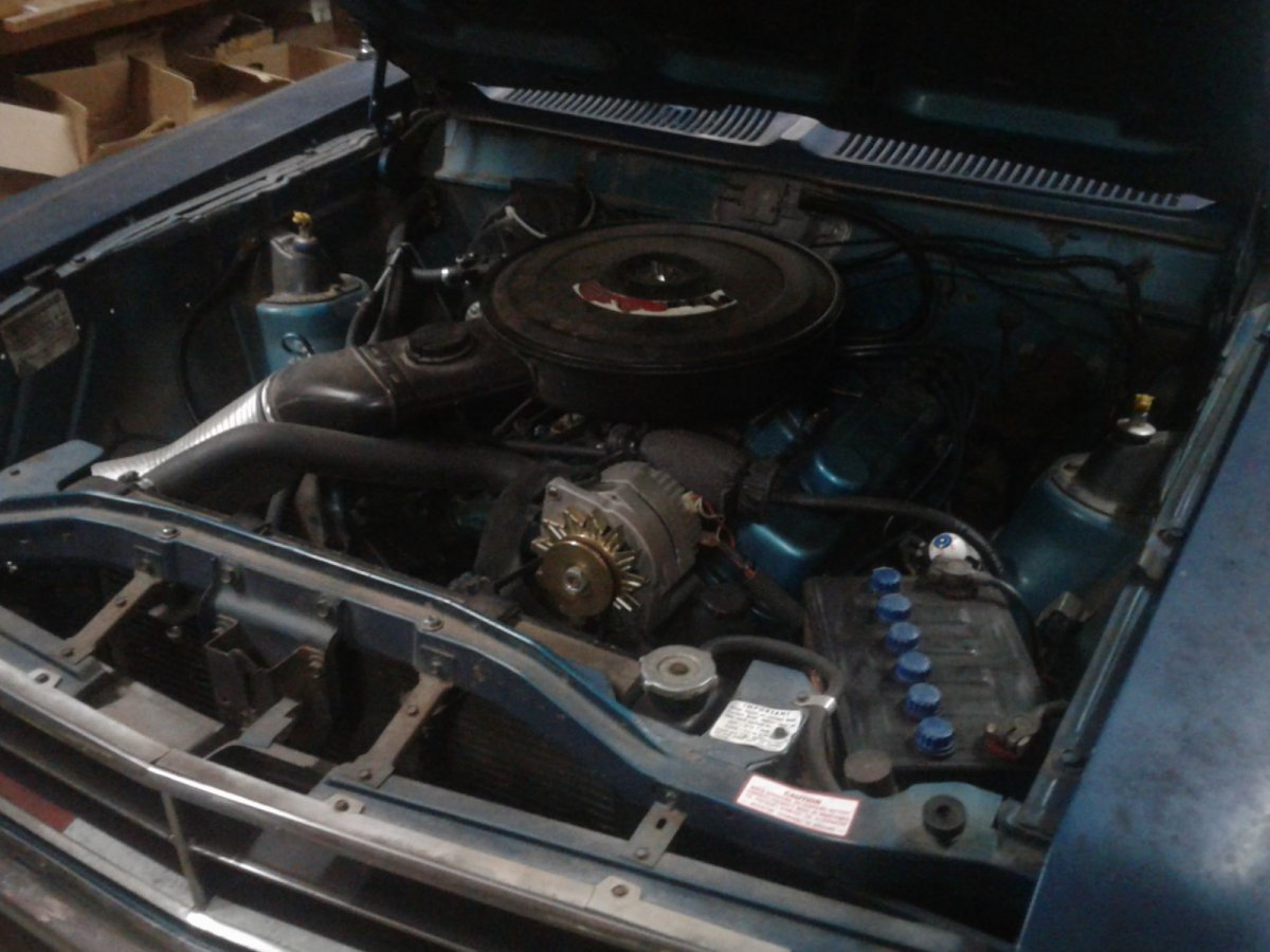

    Lunati voodoo cam, keep the qjet,buy cliff ruggles book to build it,
    These engines make tq, don't spin it over 5500, gear in the 323 to 355 range.
    I have this combo in a Pontiac 455 powered amc 4door rebel(sleeper).
    Tried a Holley on it, qjet way better mpg, and dialed in right equal power to Holley. Still have log manifolds, the factory 4b cast intake, is hard to beat.

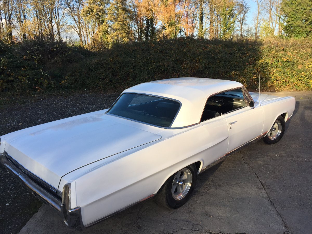

    Nice car...I can’t remember if 64 was one of the years that had a nylon cam gear. If it is change it ASAP and while your at it, upgrade the cam, manifold, carb.
