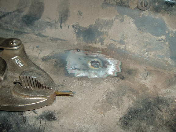

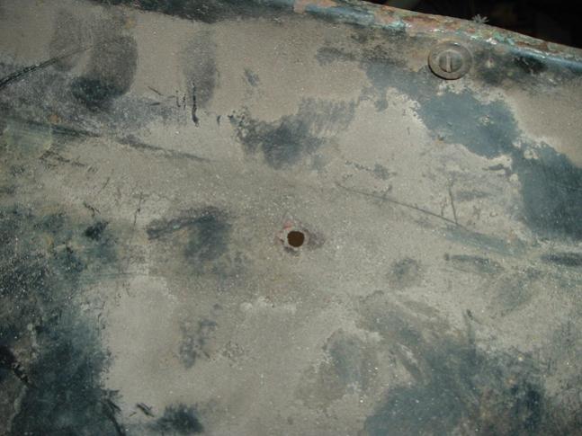

    When disposing of things, I usually make sure I have absolutely no use for something, even if it's use could be unconventional. I saw a box of brass paper fasteners we were about to throw out at work. How long has it been since you've used these for their intended purpose? I thought that since they were brass, weld wouldn't stick to them; so they might be useful as a backer for welding holes shut in sheet metal. I figured: grind around the hole, insert paper fastener from behind, MIG around the opening, grind smooth. If you didn't want to hold it in place with pliers, you could expand out the little tabs as well. I gave it a try:
