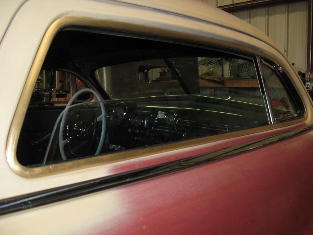

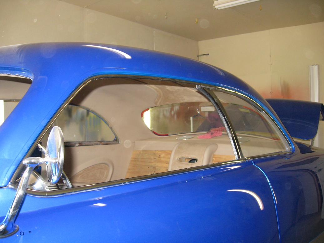

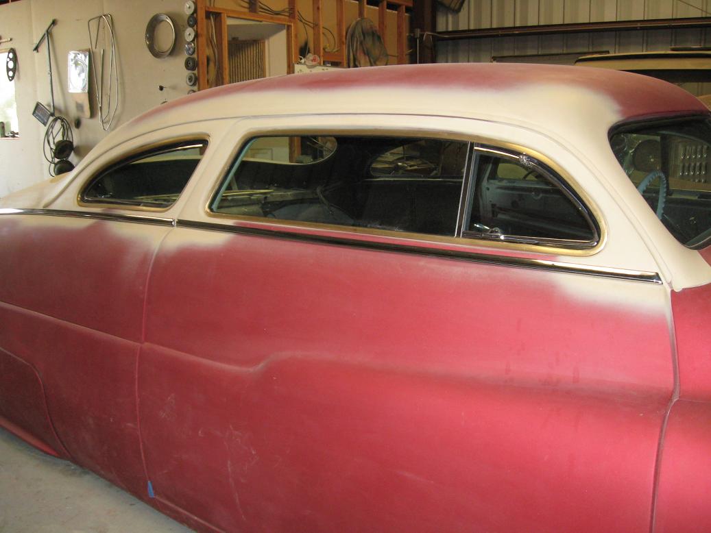

  4. slddnmatt
    Joined: Mar 30, 2006
    Posts: 3,685
    slddnmatt
    here are some pics of the installed pieces. the ones on the shoebox i just got back from the plater.
