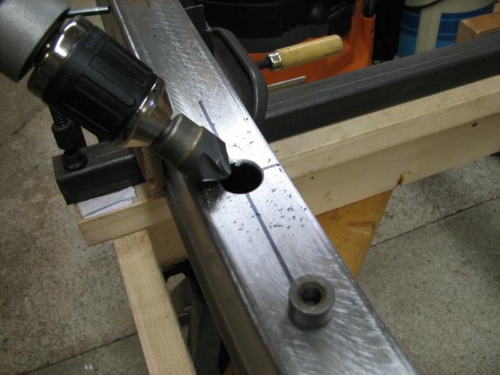

    Waht do you do when you want to bolt something to the frame though?

    There are a couple of options for body mounts. Here’s what I did. I have a bag full of these threaded bushings. They're ¾ inch outside dia. by ½ inch thick with a 3/8-16 thread inside.
    I drill a starter hole, and then plasma cut a 1 inch dia hole with my luan pattern.
    Next, chamfer for welding.
    Screw something into the bushing to hang on to and hold it in the hole a little below flush and tack weld it in one spot. Plumb it up square and tack again directly across from the first tack. Plumb it again and then put two more tacks between the first two. Now weld it up. I leave the stud in the bushing till I’m done welding to keep spatter out.
    The frame can be drilled and tapped for small stuff like brake line hold downs. For other things like fuel pumps etc. your best bet is to make a bracket with the holes you need and weld it to the frame.
