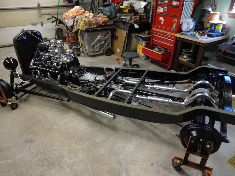

    Here's a couple of pics for you where I currently at. Test drive with no doors was a good time. Lots of guys have seen it and nobody thought it was weird looking.

    Coupe is turning out every bit as impressively as the tech thread it began with! Great job.:)

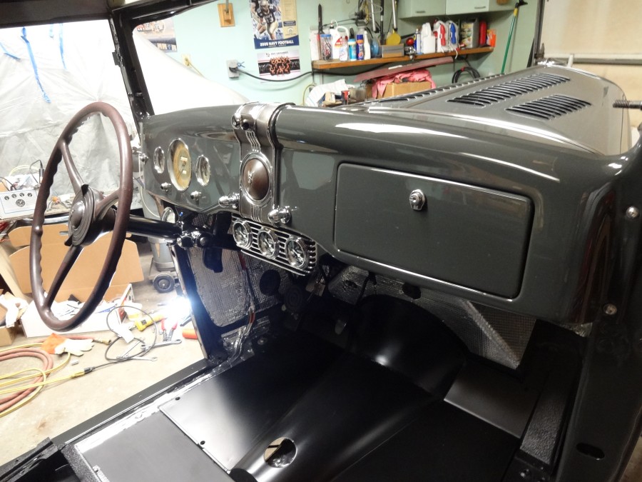

    Here's a couple pics of the dash. I'm leaving the steering wheel and waterfall un-restored. The tach is an old "Radatron" that works beautifully. And, the horn ****on works! steering install_016a.JPG steering install_023a.JPG

    WOW ! Amazing build. Thanks for posting. That dash is fantastic, as is the whole car.

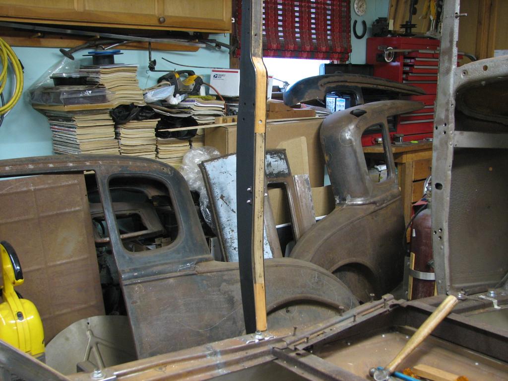

    Here's what it looked like before....just a bunch of cast off parts.

    From humble beginnings....makes it even more impressive. Now one of my favorite builds!
