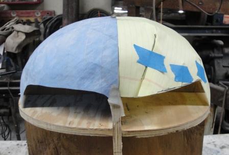

    First thing I did was to make a pattern. I did two different ways; one paper and one using a fexiable shape pattern.

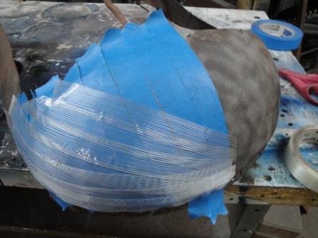

    The flex pattern is just several layers of tape, first layer is painters tape folowed by two more layers of fibergl*** tape.
    Here the patterns are on the buck

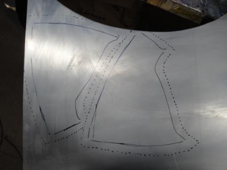

    Then I cut out the blanks with about a 1/2in extra all the way around (for t******* and welding)

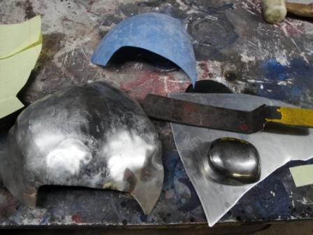

    NOW I told you that I was doing this LOW BUCK... It doesn't get any cheaper than this... Baseball bat mallet and a hollowed out stump:eek:
    You start hitting the metal down into the hollow as a fold forms you smack it down flat
    this is what you get after about ten minutes work,, a roughed out shape:cool:
    Now you have to 'planish' smooth. I used a dolly and ******* made out of a old leaf spring.. Just hitting it lightly until the lumps disappear
    Here's the two pieces ready for a little t*******
    Now I placed them on the orginal rad shell and scibed them for a final trim and welded them together.

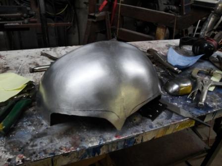

    And with a little filing and sanding you get this:D
    And you can still see the hammer marks on the inside

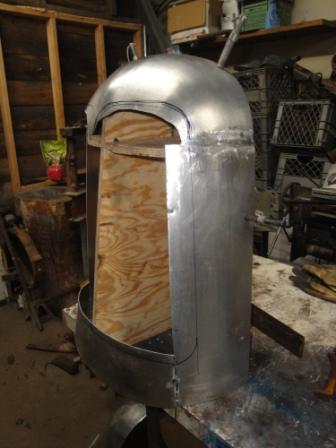

    Here's some of the finishing steps...
    Cut out square blanks, bend into a radius, trim to fit ,weld.....
    Got all trimmed up and got ready for the step that holds the hood.
    Here's a little tool that you can use to make a step.. Just a pair of old vice grips w/a tab welded at the end.
